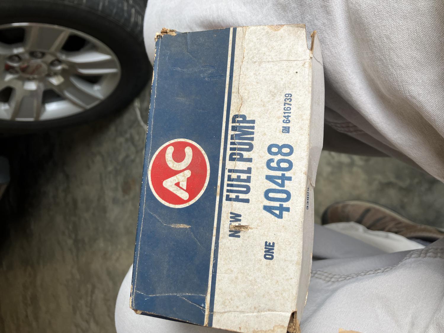

I bought this one from Jim Stubbins back around 96 or 97 as a NOS unit for a 67 Camaro L78. I’m not saying it’s correct but it worked fine.
Richard
