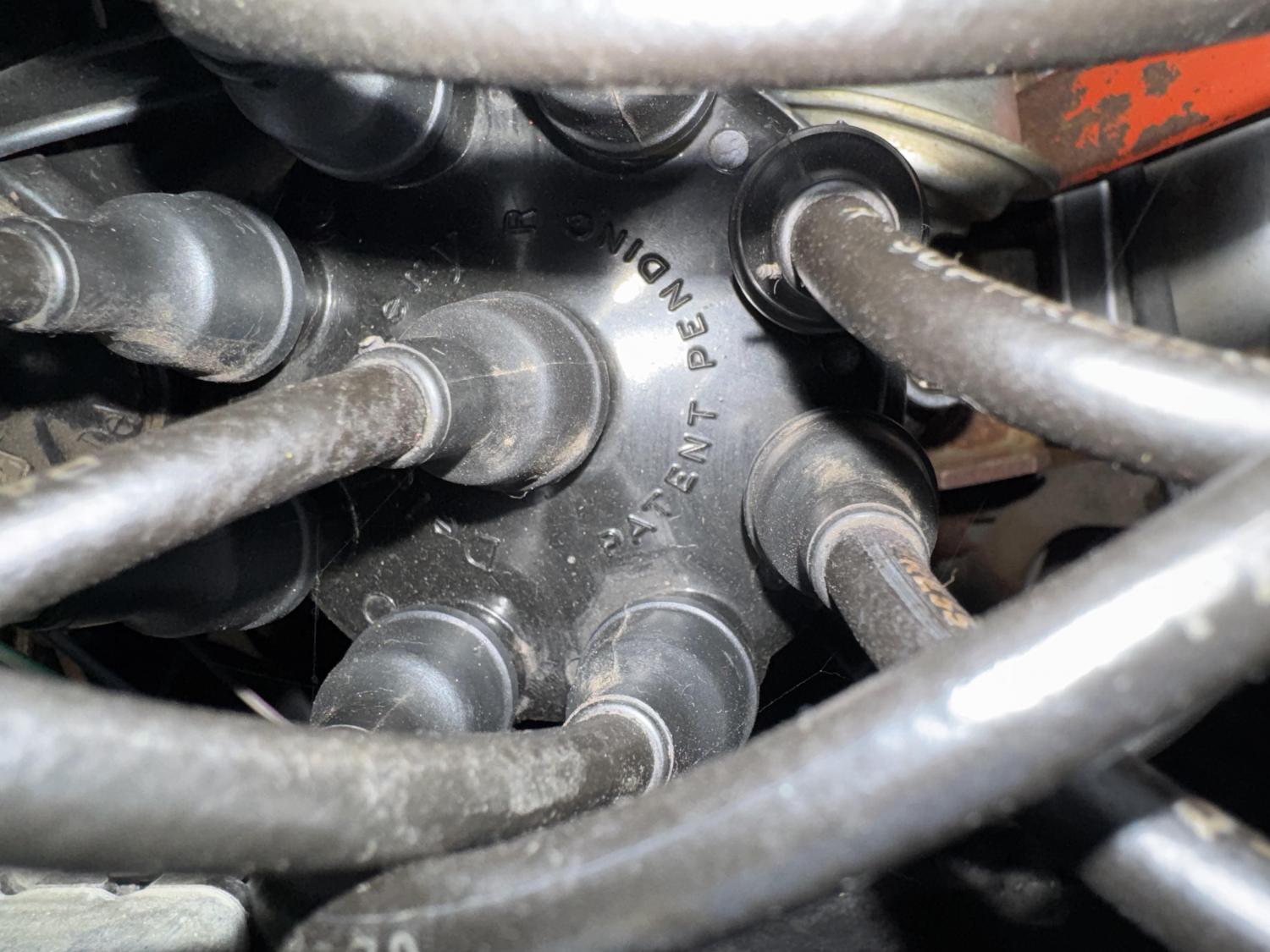

The 1970 Z/28 would have had the "Delco Remy" "Patent Pending" R distributor cap from the factory. The "Patent" 2769047 and the cap without letters would be a service replacement cap.

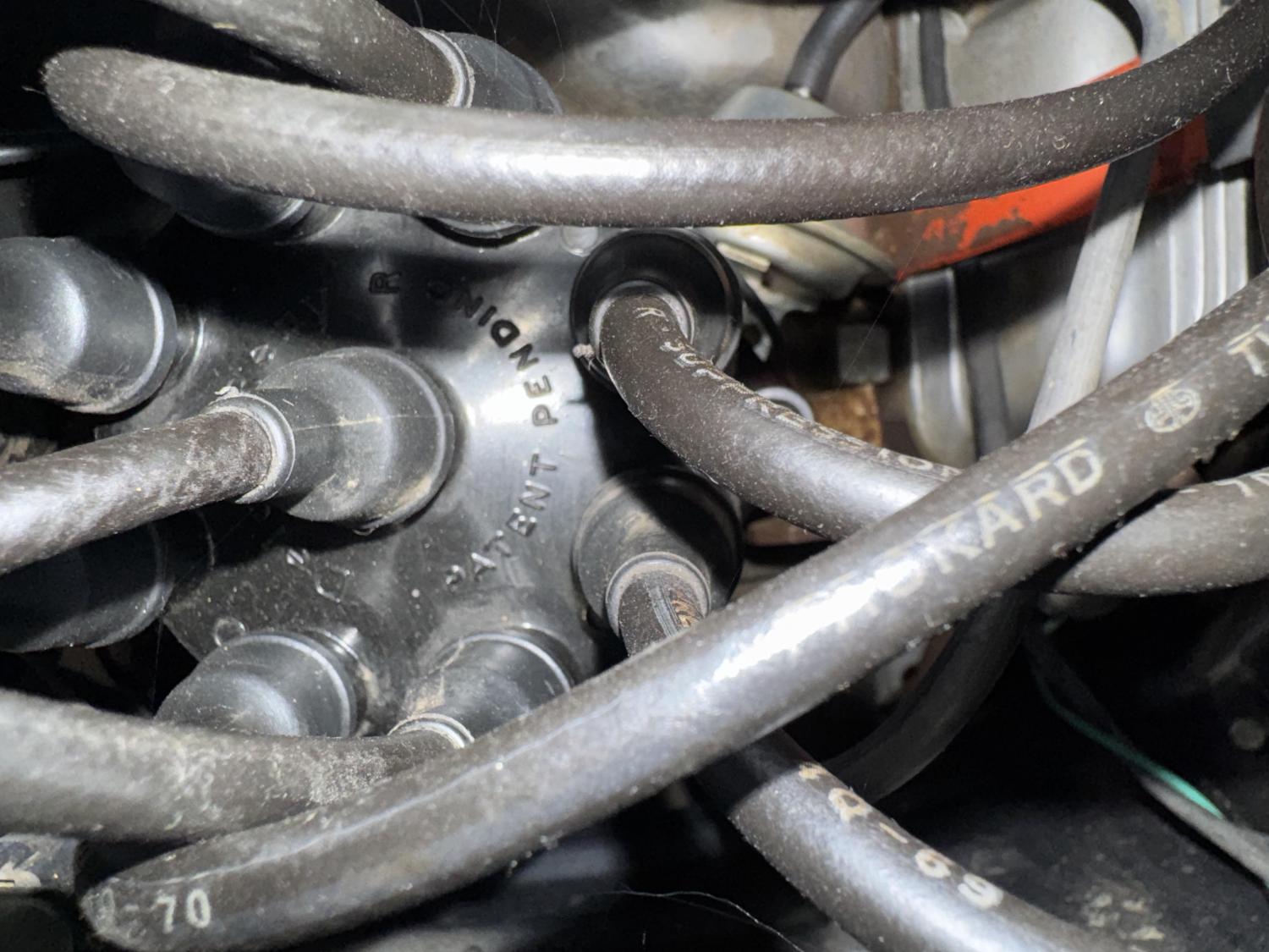

early and late "patent pending" caps.
Pic 1 is earlier type. No "R"
Pic 2 is later type with "R".
They are saying you need bottom type.

"Patent Pending" cap is for 1968 and earlier for all GM models.
