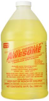

Don't use brake fluid,use this,LA's totally Awesome Cleaner.I've been using it to strip paint and plastic chrome coatings off of plastic for years.It' will never hurt plastic and only dissolves paint or applied colors.https://www.dollargeneral.com/p/la-s...z/722429640222...You can get most anywhere,but cheapest at Dollar stores.

so do you have to soak it in this cleaner or just work it in

Soak it,not rub or spray on as it takes time to loosen the paint.I usually fill a tupperware container and put all my small pieces in it overnight un-covered & no gloves,(it's not caustic)...A good 12 or 24 hours should suffice at warm room temperature.Then rinse your item under running cold water and towel dry.
Being yours is a much larger item,I would buy a few gallons and soak half of it in a bucket or drum,then repeat on the other side a day later.
I re-use mine over & over & over again,after I filter out all the loose crap.
Once it turns dark & weakens,you can dispose down a sink/toilet.
