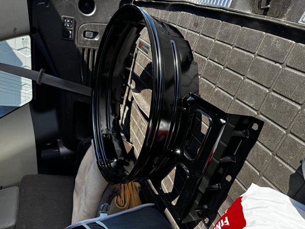

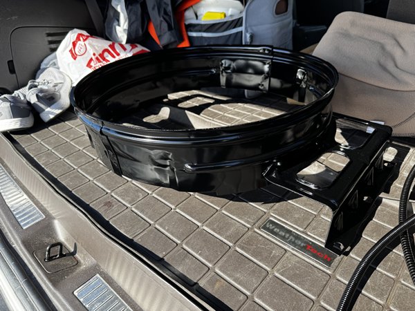

I picked up the balance of the parts being painted this morning so tonight the re-assembly begins.......
