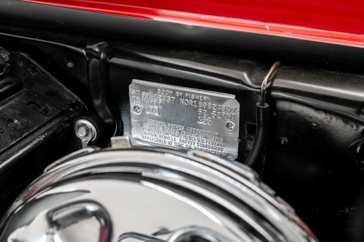

https://www.ebay.com/itm/116443159808
124379N545079
1969 Chevrolet Camaro SS Iconic
N545079 was final-assembled on or about November 19, 1968. Body tag has two obvious errors.

Gotta love the ground strap on the bolt that mounts the wiper motor.
