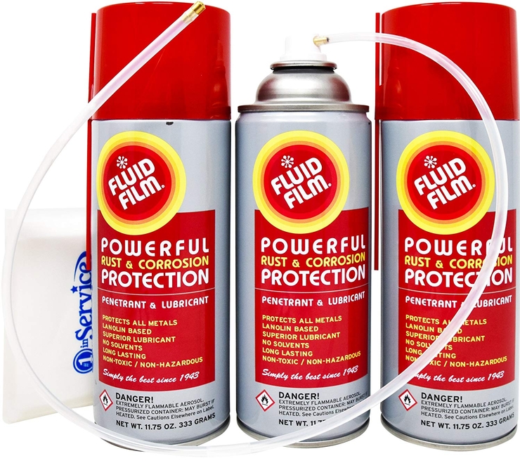

Anybody have experience using FLUID FILM on hinges as I believe FF is a great Rust Inhibitor on ALL Phosphated Steel Parts................
