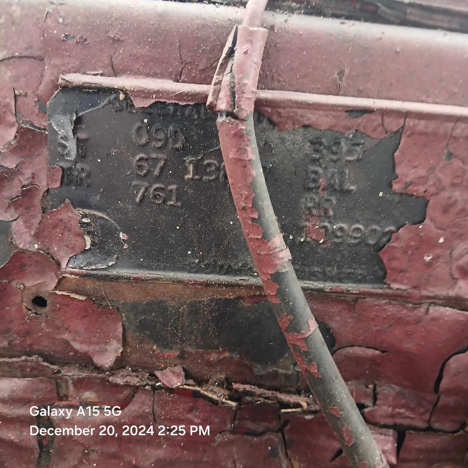

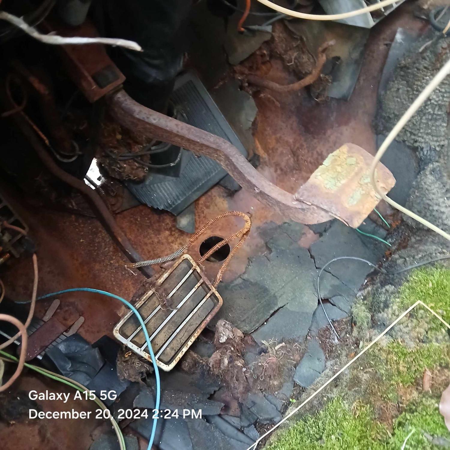

Heard from seller this evening and I'm going to check out the Chevelle tomorrow morning. He sent me some additional pics...has three pedals, but was converted to automatic. Engine pad should be real easy to see. I'm looking for an EG code stamp, correct?

Trim Tag date of 09D (late September 66) precludes it being an L78, since they weren't available until late spring of 67. That thing looks awfully rough.

Great point Bill...I'm still gonna go take a look...morbid curiosity and it's 15 minutes away from me.
