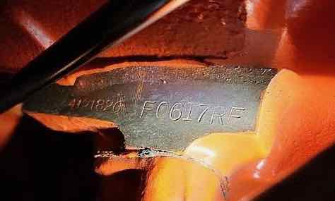

Nice colors. Thoughts on the deck stamp?

I don't like the stamp.

The stamp photo isn't very good, but I don't like it either. I do not know much about 64, but there are 2 red flags despite the poor photo.
The hood fit is terrible.

Serial number font and spacing in particular isn’t authentic looking.
