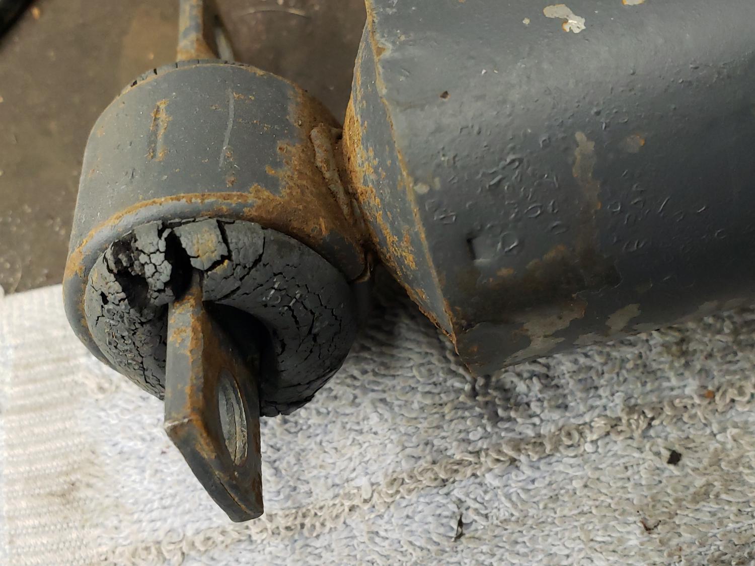

Default Replacing worn Delco Shock Bushings ???
Corvette Central sells reproduction REAR rubber upper/lower
63-82 Delco Shock Bushings
Dan's selles the front lower for $20.00 EACH....
Anyone able to share specific help on removing/replacing
the bushings in the below pics

I made my own bushings using EPDM rubber from McMaster-Carr PN 1241N12
Turned/bored them on a lathe to the size I wanted for a good press fit.
Lubed them up with Vaseline and pressed them in using a vice and select sockets
Not rocket science. Just time....

I have a press and pressed mine out, lots of lube when reinstalling
