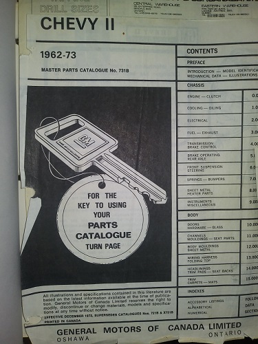

9566BA I found this note in GM product info program,#38 smaller bumper on top of door & #37 larger bumper on bottom of door.
Hello sir
Where did you source the reference book you are showing pictures of?
Thanks

Default Gm catalogue
Good day, crossbreed383 this info is contained in the master parts catalogue for chevy 2 & nova. If u need some pages copied let me know. Thanks for your interest. Marc.
