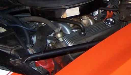

Engine bay photo of 1 owner 21k mile Z/28 built on or about September 29, 1969.

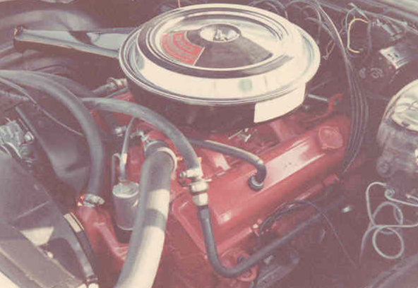

Even used on L48 engines. Vintage pic.
