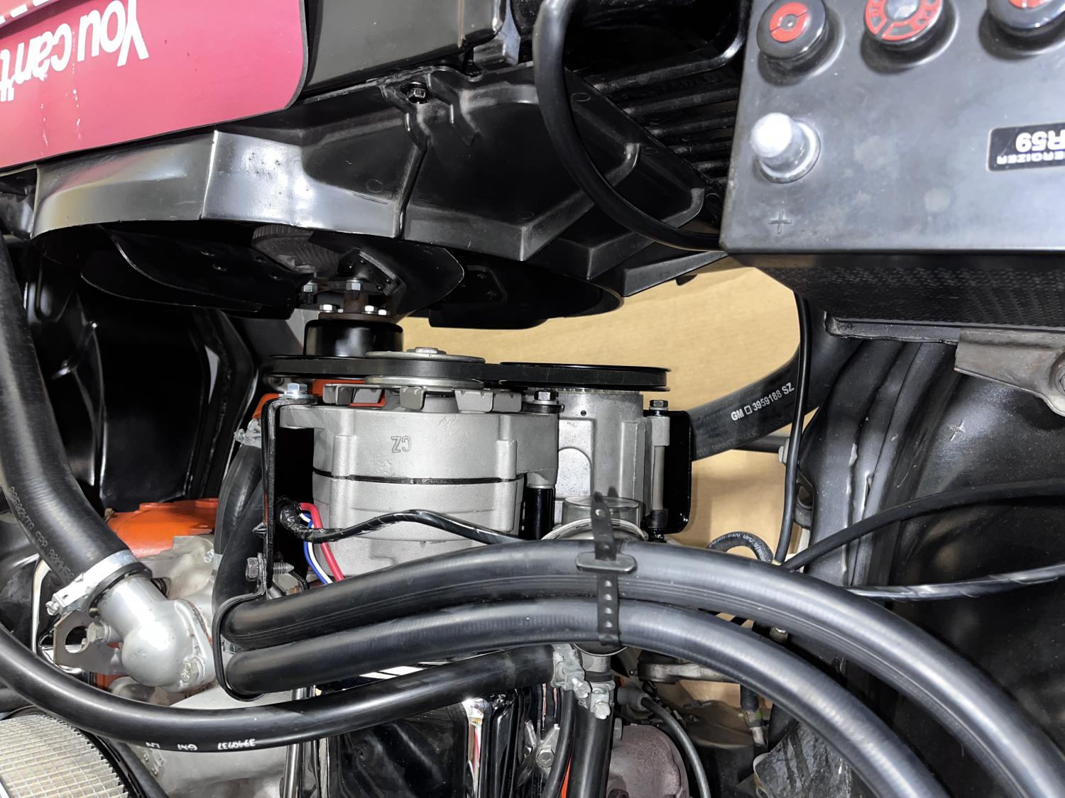

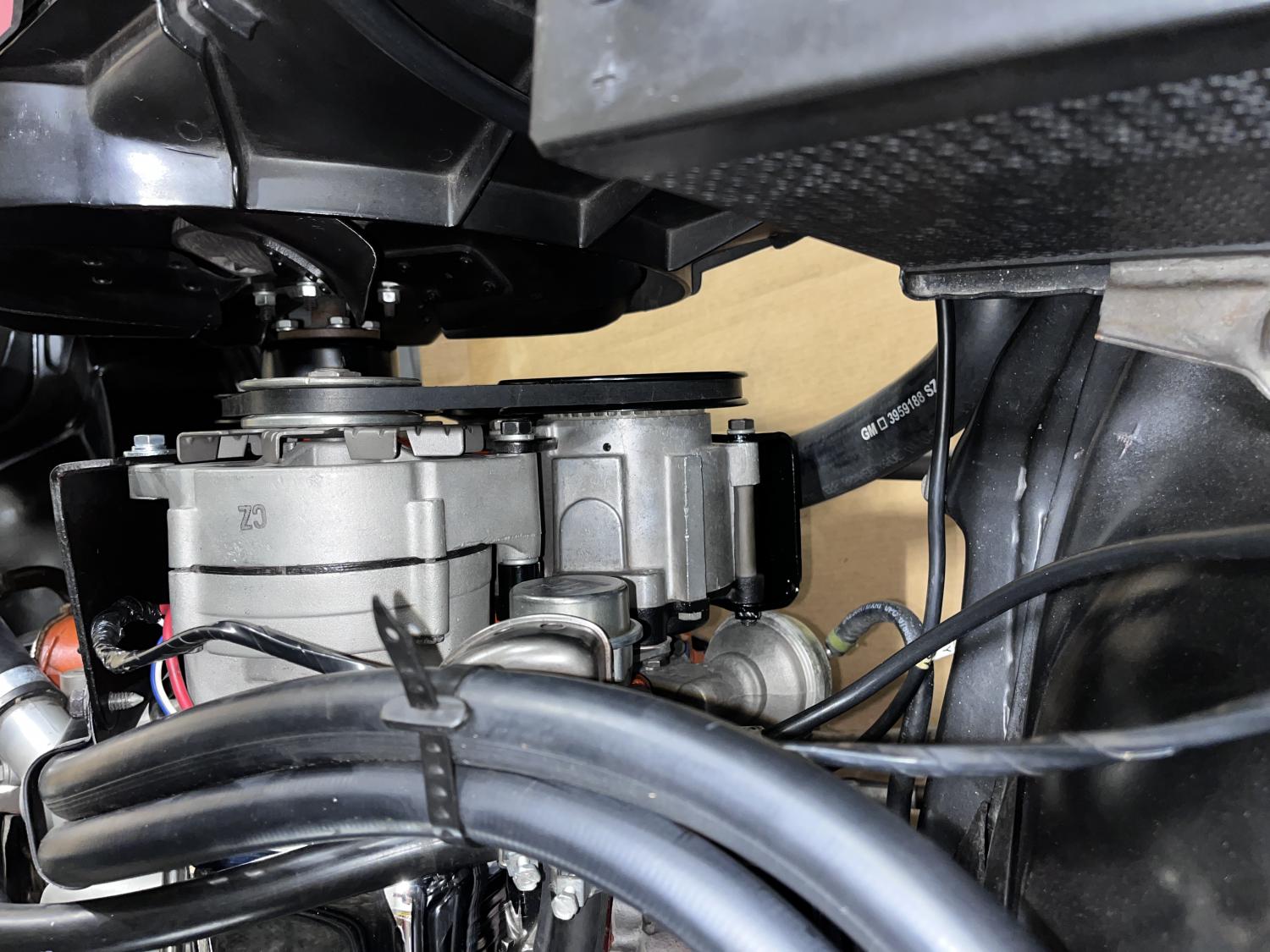

Has anyone had a problem with the smog
Pump not lining up with the alt. , crank,
Pulleys. The smog pump pulley seems to be
1/4” forward of the other pulleys.
It’s a remanufactured pump, and aftermarket
Pulley, brackets, ect. This is on my 69 COPO, Chevelle, original
Drive train. Any help would be greatly appreciated. Thanks , Dave

So I took my smog pump bracket off,
And matched up the off set to a new
One I just bought.
There’s approximately 3/16 difference,
The new one aligning the pump,
3/16 towards the block, witch is
The direction it needs to go.
I will mount the pump with the new
Bracket tomorrow, give u all another
Update. Dave

Default Original GM brkt. Installed
Here I have installed a good used GM
Smog brkt. The alignment is how it
Should be now.

I just did the same thing, then pulled out a lower alt bracket that had a mushroomed out spacer, installed it and everything was perfect
