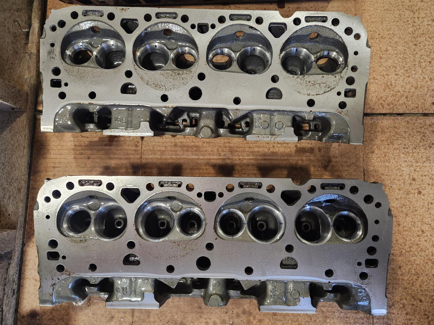

1969 #3927186 heads fresh from the machine shop all cut out to 2.02 intake and 1.60 exhaust valves. Heads are dated D-2-9 & D-29-9
Unshrouded intake valves and bowl work
Screw in studs conversion
Cut guide bossed .500
Milled heads .015 to true up the surface
Competition 3 angle valve job
Pressure tested
Cleaned and magnafluxed
Heads just require the hardware ready to assemble. Complete rebuild kits with screw in studs and guide plates start at $181 and up at Summit Racing.
