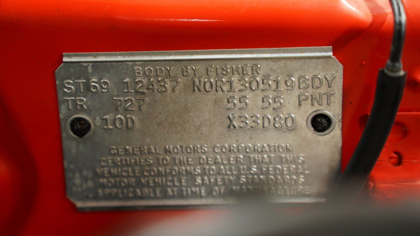

https://www.ebay.com/itm/276290558343
124379N528551
N528551 was final assembled on or about October 23, 1968. That's one month prior to the second design body tag, two months prior to X codes and several months prior to spoilers being coded on the tag.
No idea why they had it coded for Turquoise/Parchment standard interior, then painted it orange and installed a 713 interior.
Guess you don't get much for $70k these days.

The amount of scammers and thieves on the Net is astounding and disgusting!Sad state of affairs.

Yep thats a reproduction cowl tag on there.

Looks like the grill and headlight covers were maticulously installed
Probably not a real RS or Z

Thats really bad
