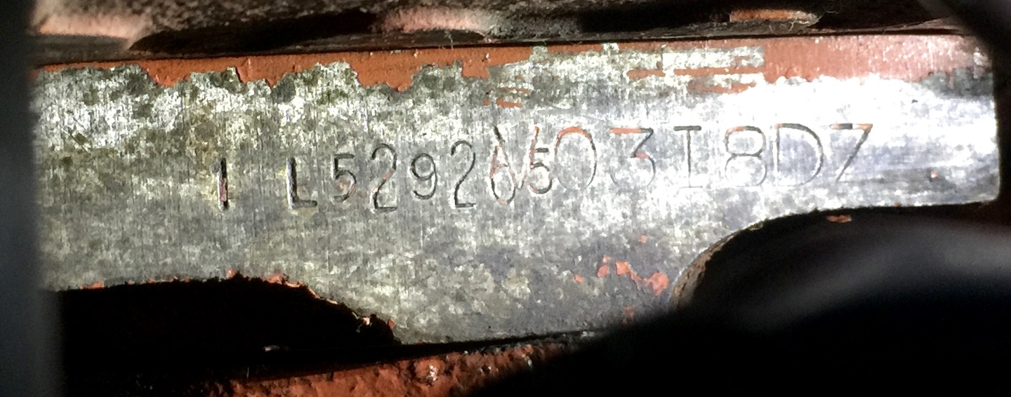

I recently bought a number of parts from a long time circle track racer. This block was in his stash. Anyone know of this car?
Thanks,
Jason

Not in my info. Looks to have been lightly decked.

Thanks. Yes, it has definitely been lightly decked but it’s legit.
Jason

----Is that one wonky 4 a known anomaly?....Bill S
Yes, it is a known anomaly at the LOS plant and not just with the number 4.

I noticed that too, Bill. I remember seeing that before.

Funky big 2’s, missing 9’s-LA had it all in this timeframe
