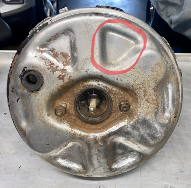

The booster is aftermarket, did not want to say anything....Original Booster has Upside down Delco Morraine logo. I can send you pics.

The top one is aftermarket….the lines on the triangle are too defined/sharp, compare to an original one, shown below.

also the "O" in Delco is round on repops - oval on originals.
