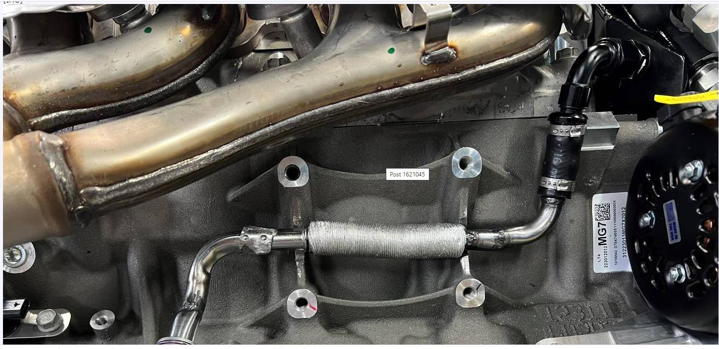

Not trying to jinx you here, but I think I would have run 100% hard line for this. That rubber coupler just looks like a leak waiting to happen. Probably won't ever be an issue. Just always looking for places for Murphy to show up. I hate that guy.
I already replaced it...... That was the last scrap piece I had laying around....All fixed now
