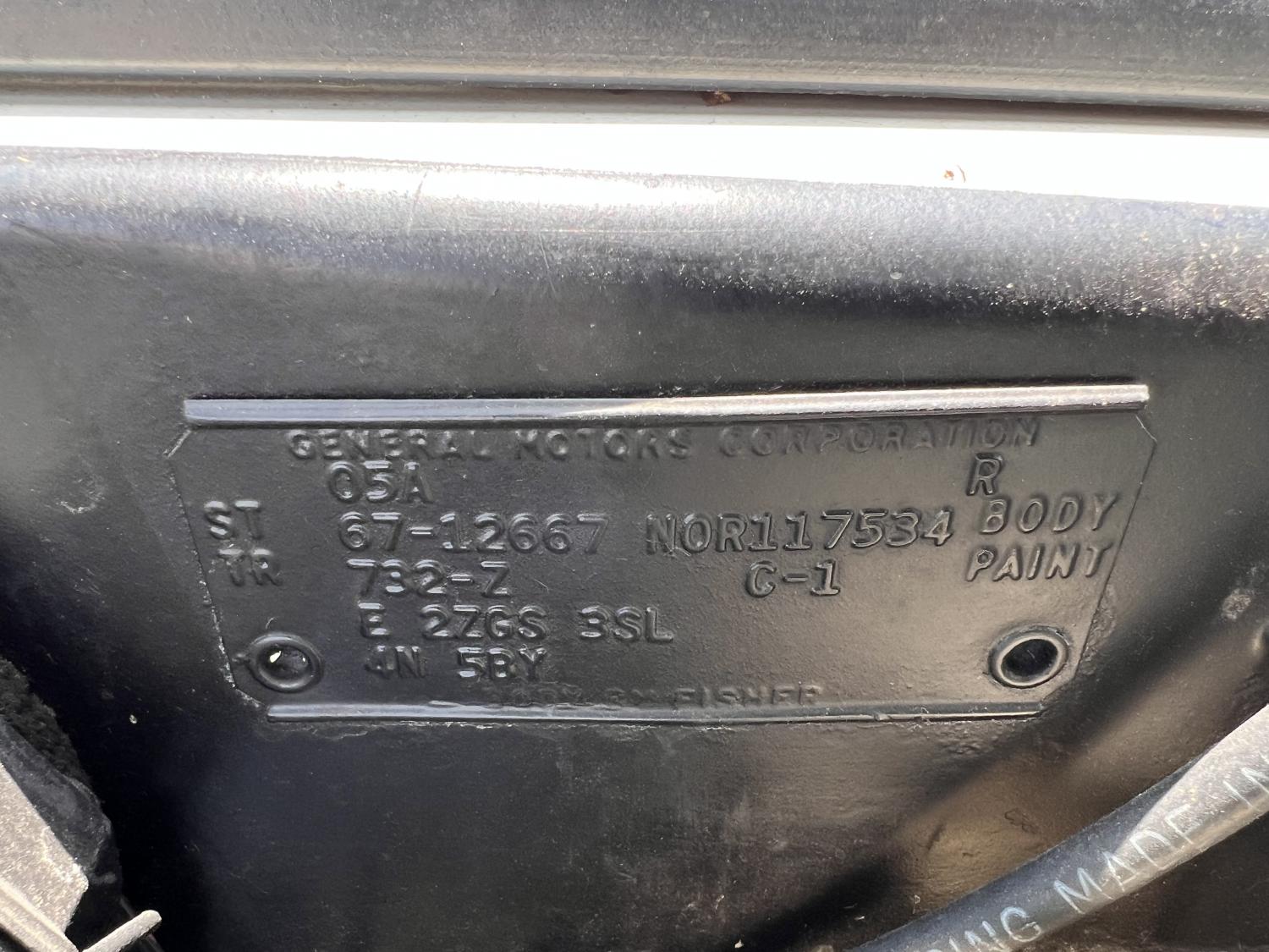

I just in the last few weeks picked up a 67 pace car big block, decent equipped car very solid car, my question is, would this car be a track car or would it be one of the dealer replicas? I have a copy of the NCR S and the trim tag what do you think?

Is it the camera angle or is the tag incredibly crooked?

Bad angle
