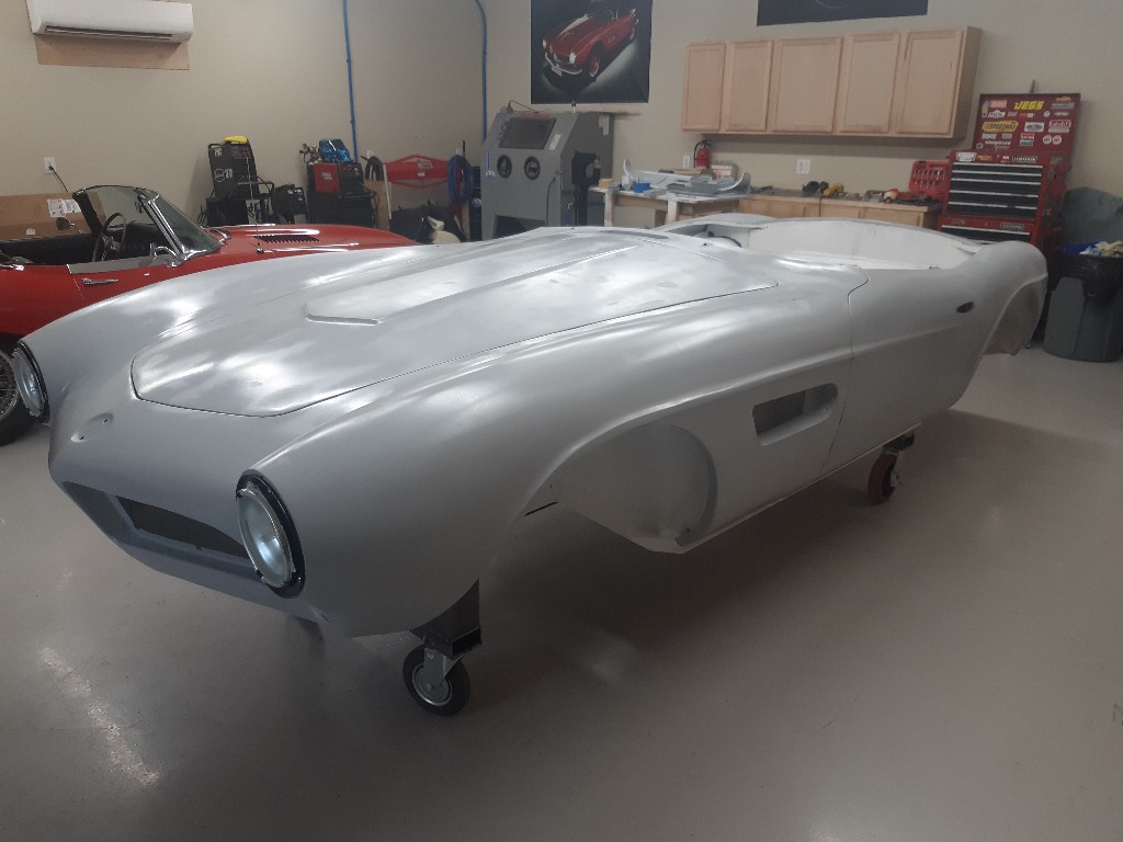

After a productive week, it’s down to 180 and getting smoother. I can put away my Pirate outfit since I’m no longer sailing the high seas. The waves have calmed down to a lake!
Next up, everything comes off (the car, not me ) and the jambs get worked over.
Somebody emailed me about hours so far on this project. I should have kept track, but I haven’t and frankly, don’t want to. I think after it’s all said and done I’ll be at at the 4,000 mark easily if you count in research, errors, redos, etc.
SoooOOOooo much fun!!!!! OMG!!!!!

More blocking, more sanding. Block, block, block....sand, sand, sand. Where's Mikey?
I had my neighbor 3D print some plastic rings that will insert into my gauge bezel. These will allow easy gauge mounting and will recess the faces of the gauges just enough to be even with the top of the bezel. I'll all some trim rings around the edge and it should look perfect.

Door shells are about done, so more pics next week! Lots of work this past month but you can only post so many pics of block sanding before you lose the interest of the audience. I'm already bored!
