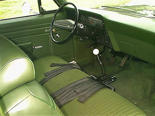

Here's what it would look like with the 4sp lever through the floor.
