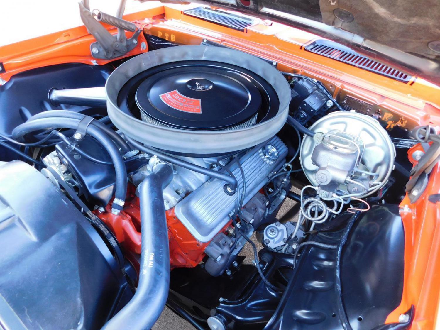

I like this car, experts what is wrong and right with this car? This is a color combo I have been wanting.

For 90K, they cant even put a cowl seal, missing rubber pieces on fender, door, Cheap PUI door panels. They did not even secure the wiring harness on the driver fender. Cant even put the heater orange cable on correctly. Z/28 Emblem not installed correctly on the grille.
Missing Smog and was probably not a Cowl induction car.
Great looking car....but the little things you should not have to do for 90K...

agree its all the small details & quality that lead you down the path of how the rest of the car has been done
Exactly! That is always the bellwether for me

With no center clock the console gauges have been added.

Well to start that engine most likely is not original, doesnt confirm the rear is either. Transmission he says is original.
In addition to items mentioned above....
You could easily spend $10K+ on missing date coded components that I feel would have to be there on a $88K car.
Distributor
Carb
Alternator
YH Wheels
Radiator
Missing bracket on manifold for brake booser hose $$$$
Master cylinder is a chinese repop
Missing Camaro emblems on the poofydoor panels - cheap repops
Should have clear knobs on window cranks
Missing windlace on rear panel pinchwelds
GM stickers not supposed to be on doors
Doors missing rubbers
Cowl induction parts missing
smog system missing
I see alot of wrong hardware
No under side or trunk pics
rad cap is wrong
Not enough pics to evaluate any further.

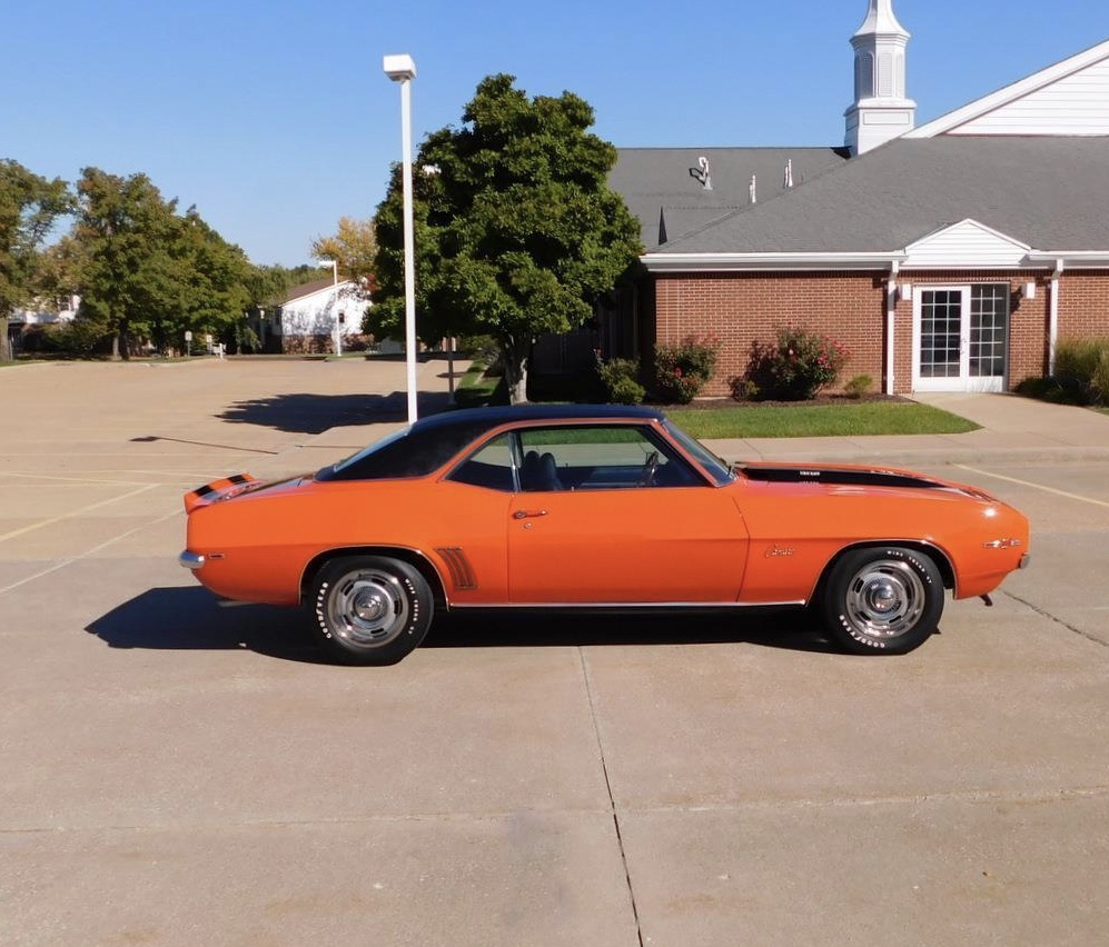

Is the right front fender a different color than the rest of the car or is that just the pic?

HI inner upper fender splash shields missing NOT worth that money
