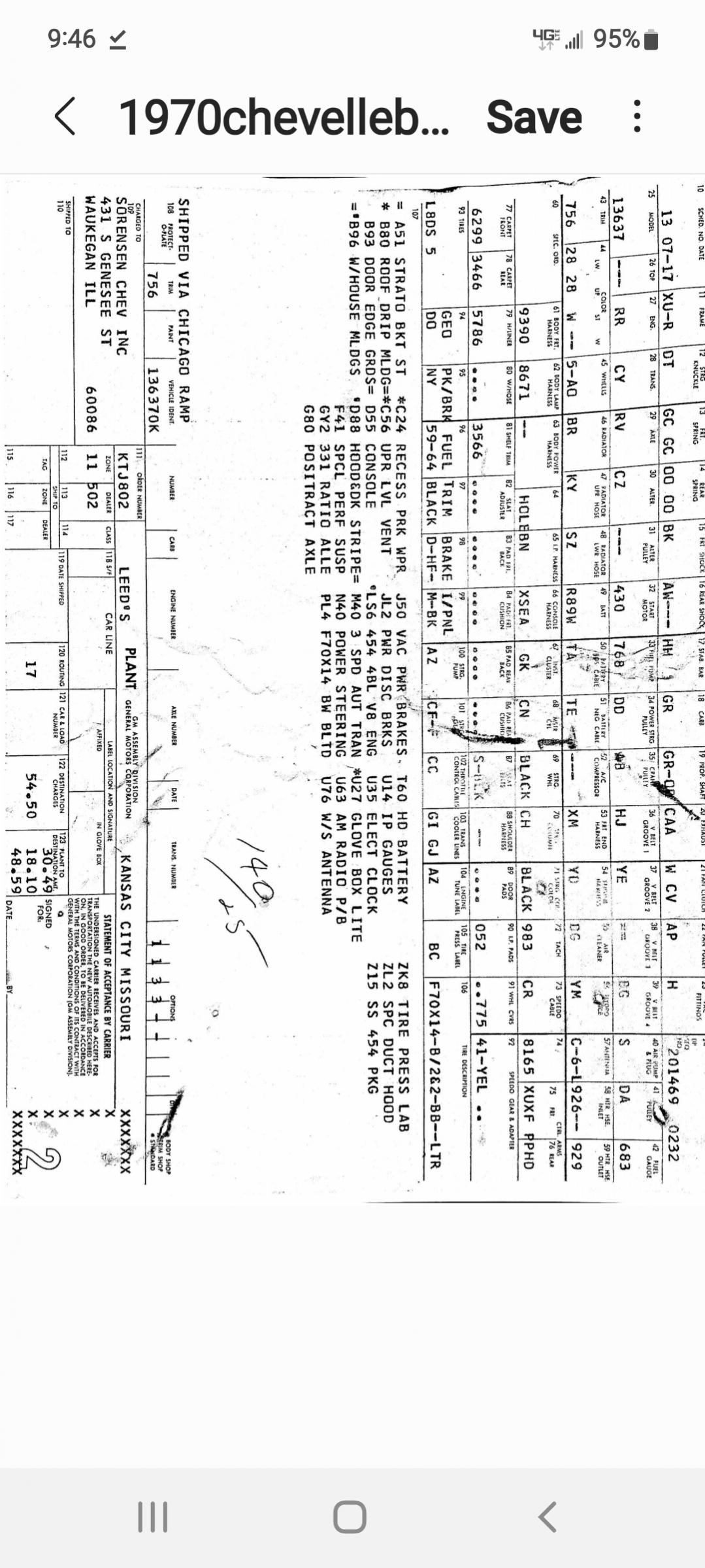

Have been watching this auction, its 3 hours away, inspection date starts 6/10, I like the LS6 Elcamino and a friend interested in Ls6 Chevelle. Question on the Chevelle, door panels and steering say Malibu, the seller said thats the way it was ordered per the build sheet. Rick was a LS6 able to be ordered with Malibu interior? If we go look and see all the build sheets, vin. tags and stamps, I cant tell if real or fake. Will be interesting, prices seem to be getting bid up early in the auction.

Well, nobody "ordered" a 70 Chevelle SS454 specifying that the interior emblems were to say Malibu, but I'm pretty certain that some of them came that way. I'll let the 70 experts elaborate.

In regards to the "malibu" emblem question. I have seen a couple fairly early build LS6 cars in person with the malibu door panel emblems. So dont let that alone be a deal killer. It did happen.

Most all LS5 and LS6 came with "Malibu" door panel emblems. On the Z15 package it did not denote the door panel emblem on the build sheet so most received Malibu emblems. Some plants like Baltimore had "SS". As far as the horn shroud having "Malibu" I have never seen that. All "SS" had "SS" horn shroud emblems.
That is a very late build Coupe. End of July. As far as the El Camino it is a last week of February with the hocky stick style smog tube.....
Would definitely like to see both of these in person.
