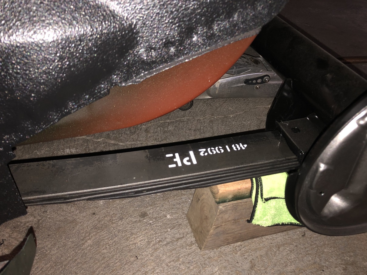

What the best product/method to duplicate the factory undercoating in the wheel wells?

I used Raptor truck bed liner and their adjustable nozzle shutz gun. I chose the truck bed liner for the durability and ease of cleaning and the gun made it easy to create the surface texture I wanted. Not sure how it'll hold up...time will tell.

As requested...this is the best photo I have in my library for the car...if you want to see any different detail, let me know.
