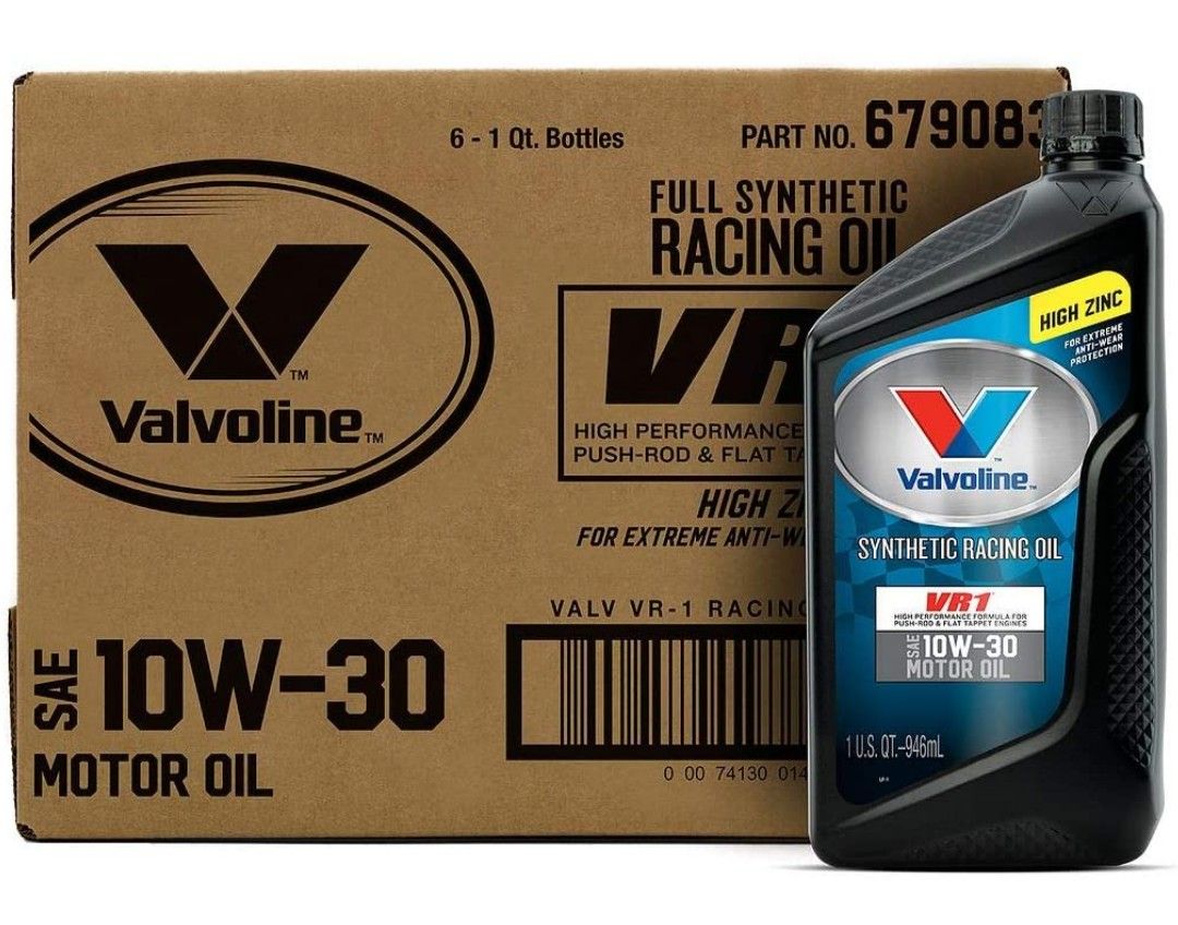

All, Just a quick question...Any recommendations on what is the best oil for a 69 Camaro 396 325HP original engine with 40K miles ? Shell Rotella 10W/30 ? Can you run Mobil 1 synthetic 10w30 ? Brand? Weight? I'm sure I can get a bunch of opinions... Thoughts? Thanks...
Attachments - The Supercar Registry VR1 is synthetic.jpg IMG_5167.jpeg IMG_2456.JPG

I use Valvoline VR1 10w30 & a Wix first line oil filter....Joe

I second the VR-1 and Wix filter [Napa Gold]...we also use some GM EOS with each oil change.

Valvoline 10W30 VR1 oil is one of the best on the market. Wix oil filters are the best too. To much ZZDP additive is not good.

Agree, synthentics will cause leakage and flat tappet clicking knocking until the oil pumps up the lifters with initial startup. Go with the Valvoline VR1 race oil 10W 30 which has proven in tests it one of the best oils on the market.

This is what I use also

VR1 10W30 or 20W50 is what i use also.
