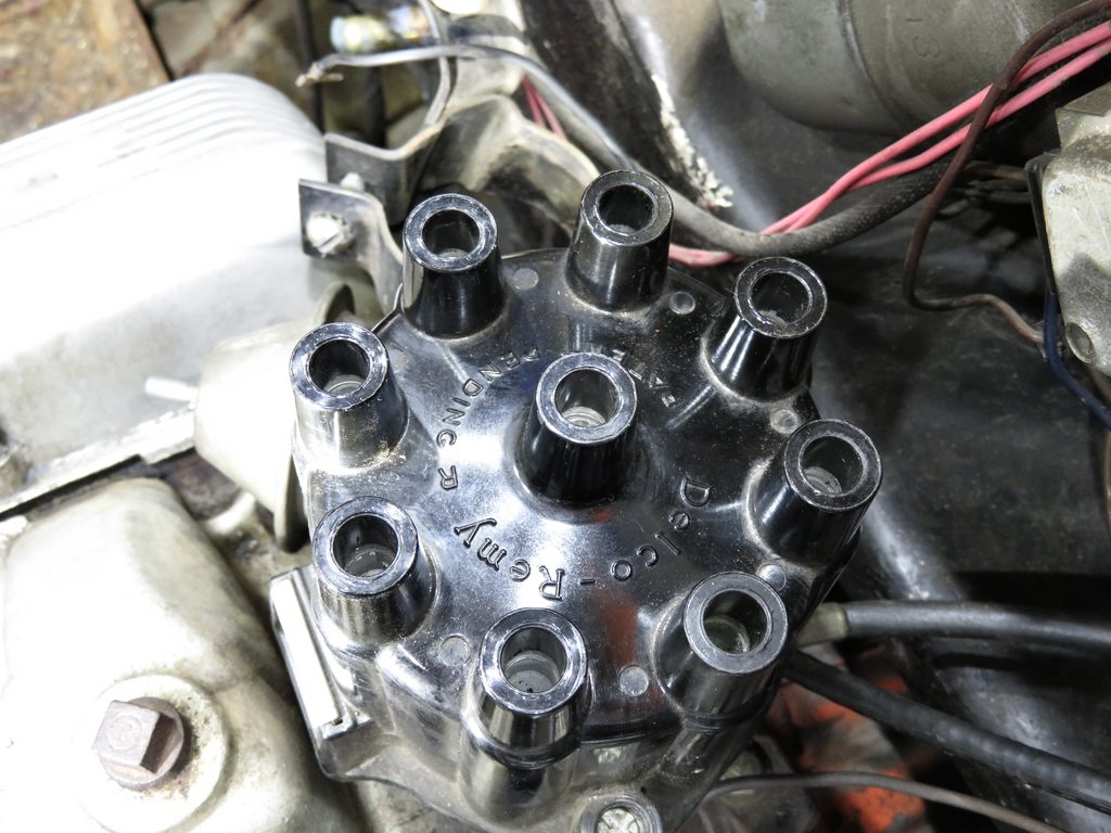

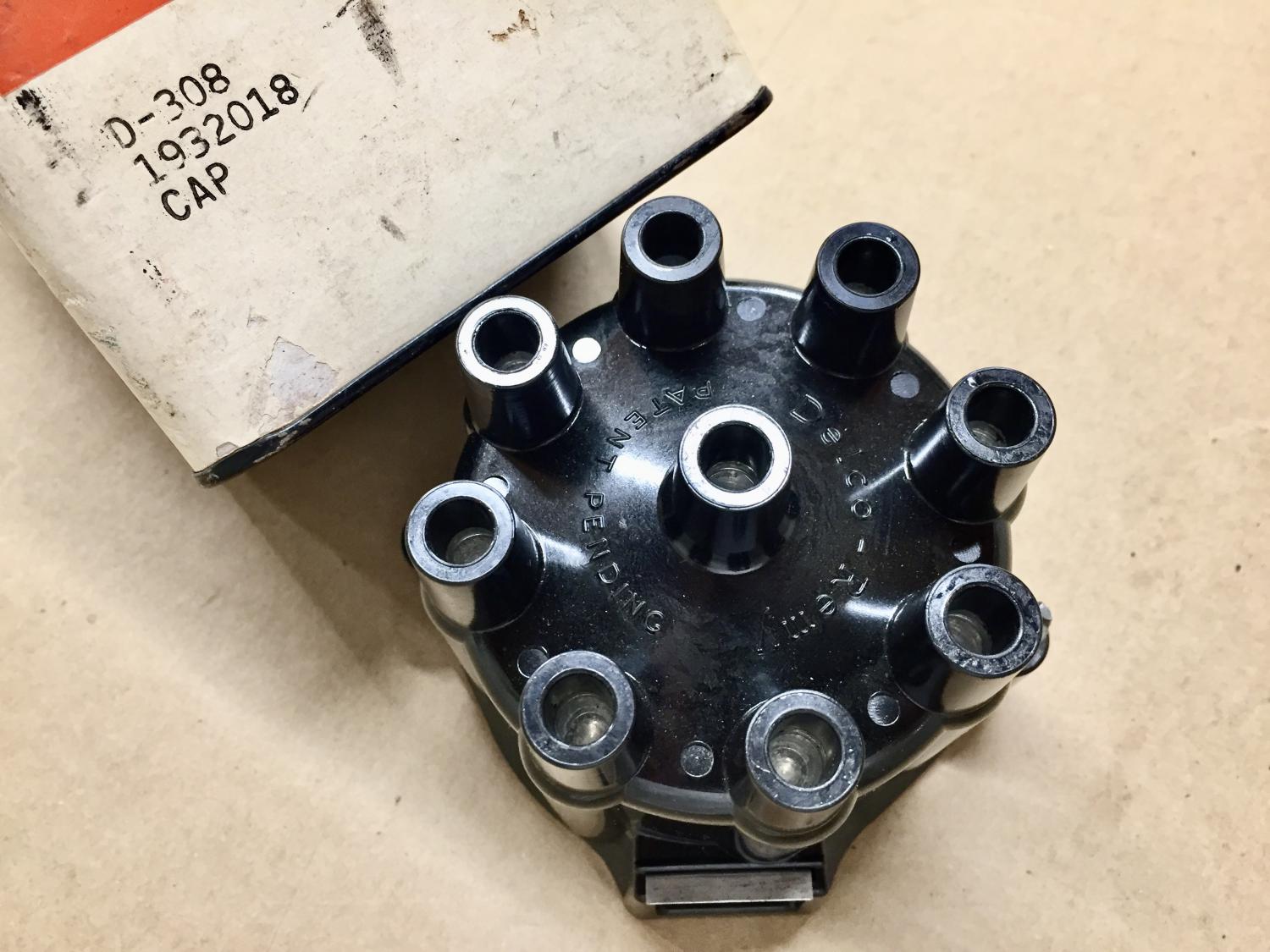

Curious, shouldn’t the Delco-Remy cap for this ‘65 be the “Patent Pending” only with the tall towers. No “R”, as I show below.

You are correct! Good catch Chris!
