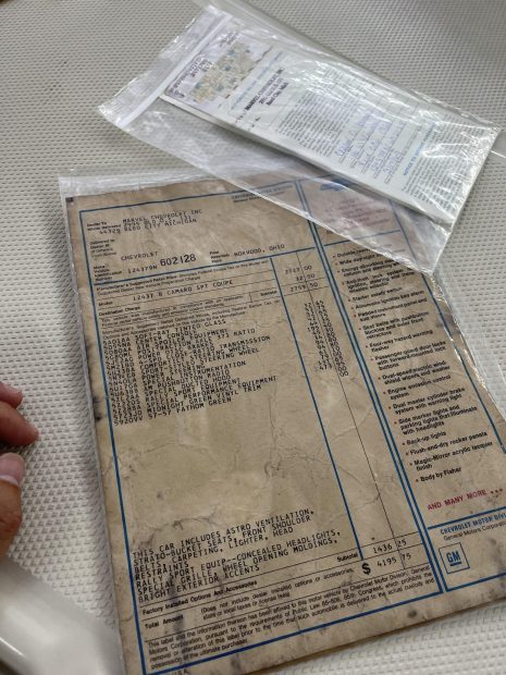

Default 69 Z28 on Bring a Trailer
https://bringatrailer.com/listing/19...MMA2O5ZAdsa22A
Looks really nice may throw a bid on it.

bad stamp on that pad.. God are folks really buying this crap

The squared off corners around the VIN tag look odd. I thought they were rounded. Replacement dash?

Dash top was replaced with the poor repro. May result in registration problems as I doubt original style rosette rivets were used to re-install the VIN tag.
Window sticker is a bad repro. POP looks to be in unusually great condition. I have no idea why anyone would write 'X33' on the fan shroud. That was installed on the Chevrolet side during final assembly.

The window sticker is laughable.
I'm stunned there's no CAUTION-FAN sticker on this one either.
