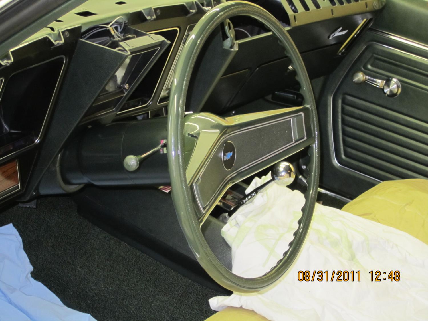

i believe that your console door is not correct green....in fact it should match exactly to the console it self....
on these color interiors, usually the plastic parts tend to fade and thus do not match together with other painted parts.....i experienced this with my dark green interior on my Z trying to repair an orig green steering wheel and matching the color to the dash or to the other green plastic, like the turn signal knob......ultimately we went with the turn signal knob.
I would pull the console and get a match to the plastic - possible light coat everything.....heck the console door is going to be perfect and the ashtray now is off?
Just some thoughts - there are no absolute correct approaches, depends on what your trying to achieve.

pic of the steering wheel - notice the diff to the dash, steering column and now the turn signal plastic knob.
