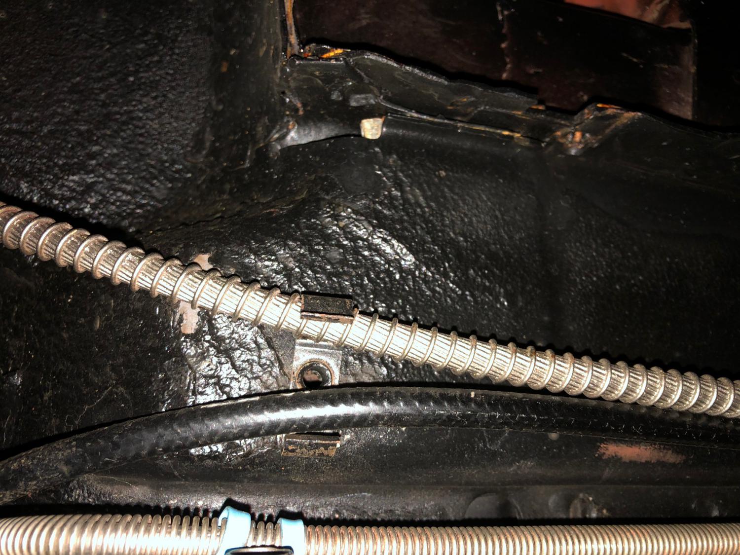

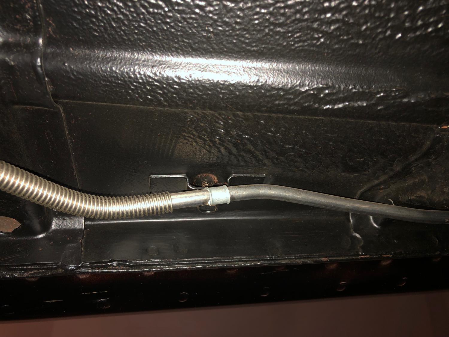

So getting ready to pull my 69 SS vert out of storage to fix previous body shop issues and need to get the floor ready. 1st shop in 1983 brazed a coupe firebird floor in (very poorly), 2nd shop partially MIG welded a new repro floor in in early 2000s (somewhat poorly).
During these issues the front speedo/e-brake bracket and side brake/fuel brackets were lost.
Before I attempt to fab them, are they available for purchase someplace? Thx
Here are the pics of them from my other Camaro
69 SS 350 convertible (in peices)
69 327 convertible (driver)
Attachments - The Supercar Registry floor brake line bracket.jpg e-brake floor bracket.jpg

Hmm, the red one is very close to the speedo bracket, even if those are for 67-68 dual fuel lines originally. thx

I ended up making a set of those for the last floorboard which was replaced. - you would think they would already be ON the "complete" replacement floors boards.

Yes, saw the ebay set, I think they look a little different than mine, I have to look closer thx
