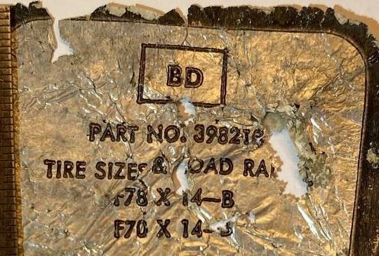

Greetings all,
I am in the midst of a project to faithfully recreate restoration detailing decals for the 1970 Chevelle community. I'm currently in search of surviving examples (whole or partial at this point) of the BD tire pressure decal.
My reference so far is almost there, however I'm missing two major areas:
#1 - the complete part number. I can read all but the last digit: 398218_
Can anyone provide a photo of the complete number?
#2 - left-side middle... which covers the loading details. A photo of this missing fragment is also greatly appreciated/needed. I could technically "guess" and use the info from other decal that are similar (EZ & BC), however I would prefer to be as close to actual as possible.
Photos included for detail and clarity of what I'm missing. Thank you!

LOL!!! Very funny.
The label shown is THE EXACT label I'm using for reference.

FWIW - the originals are printed on metalized Beer Bottle label stock which has some wet strength.
The printing process is flexo or direct impact using a flexible image plate to directly print onto the substrate - you can tell this by the "squish out" leaving the centers of the letters showing substrate and the edges looking heavy... this is from the printing plate touching the surface and pushing the ink away from the impressed area. When the plate draws back it leaves the "kiss".
Offset printing uses a printing plate to transfer the image to a carrier blanket and the blanket transfers the image to the substrate, - this process uses much less ink per sq inch and thus produces a much crisper image- it typically shows as tiny little dots under a loop - the number of dots per inch is the "screen" resolution.

Default Still need that digit!
Hey guys, and thanks for the replies.
I'm still plugging away, and have BC, EZ, and BD almost completed. I'm still missing that last freaking digit of the BD part number!!!
Does anyone have photos archives of an original fragment of this decal that shows the full part number?
That is all I need. This decal is complete otherwise...
