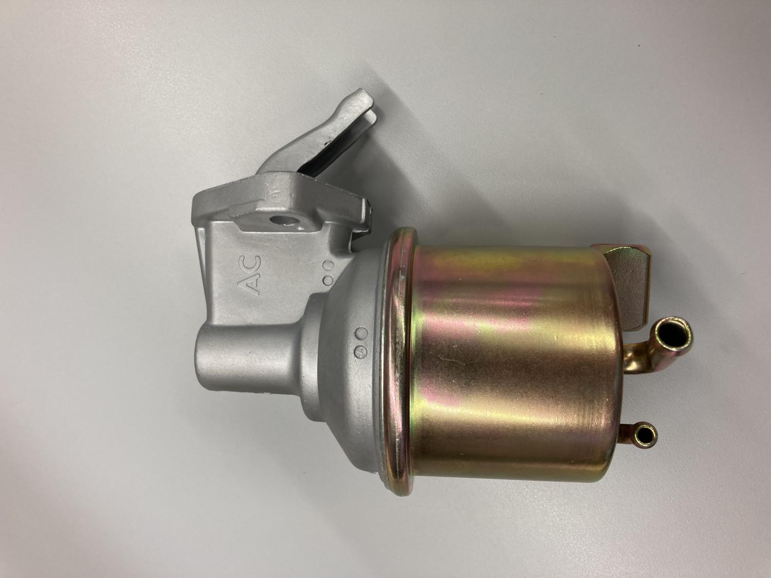

My fuel pump arrived today from Fred Ballard.
I decided that it is likely I will damage the original brake line running from the distribution block to the rear when I remove it (it is not cooperating at all right now even with persuasion in the form of penetrating oil) so I ordered a new one from Inline Tube along with their version of the flex hose to the rear axle lines and should have those by the weekend.

Fuel pump looks awesome!!
