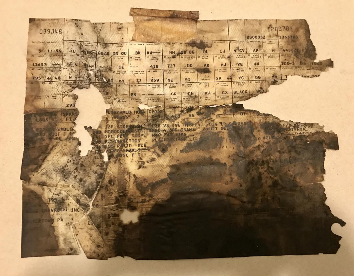

The build sheet looks good. The seller probably confused the job sequence # on the build sheet with the VIN sequence. Here is a picture of the build sheet from my November built Baltimore 70 L78. The VINs are very close, assembled on the same day.
