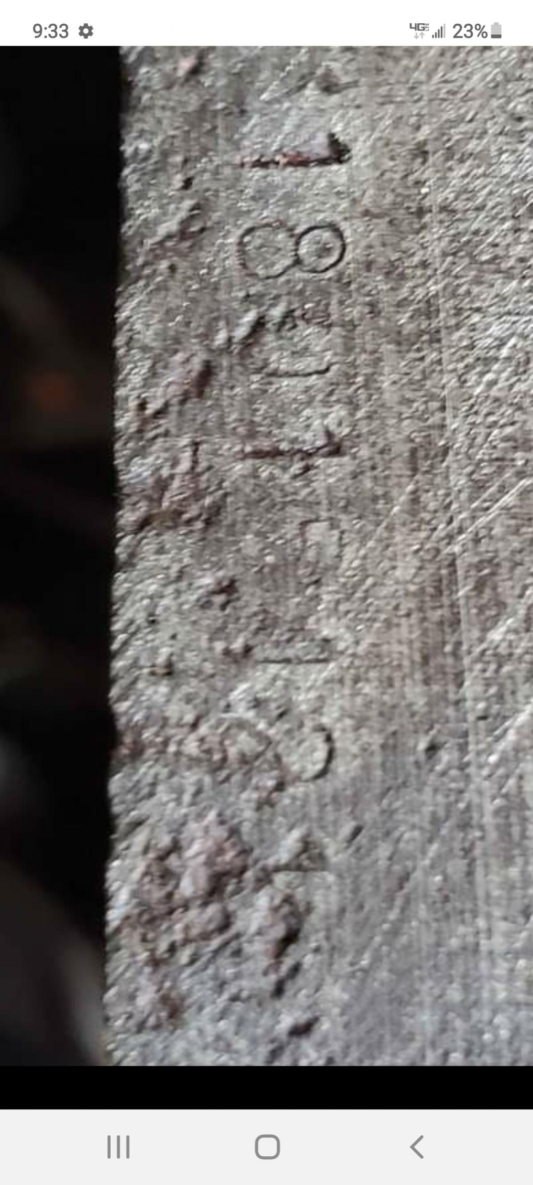

If you can clean off the surface where the partial vin is, I can check my database to see if the car may still exist. Looks like it starts 18D1 but I can't make out the rest
Thank you. I will go back next week and get a better picture for you. Do you track the 385 hp cars also?
Its still not great. Car was in Delaware.

This one is a little better.

Maybe 18U15421_?
