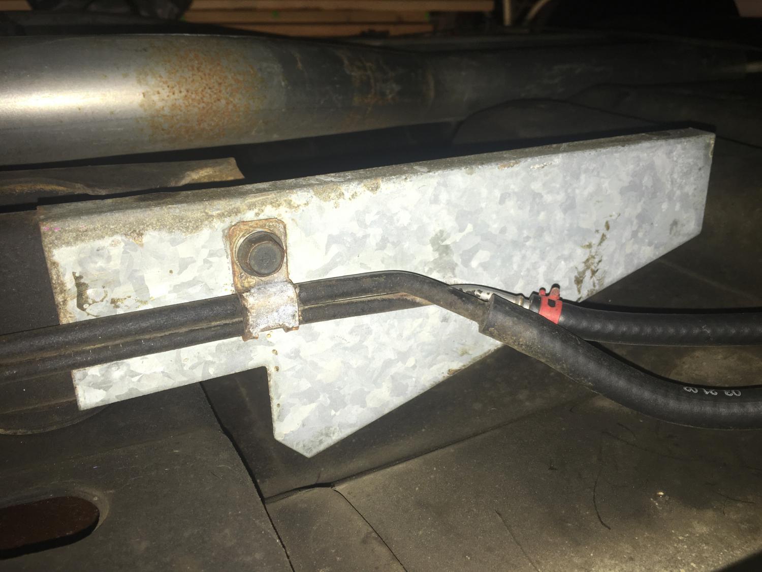

This is mid way on the sub frame, I cleaned it w/ WD40, you cant bead blast Galv.

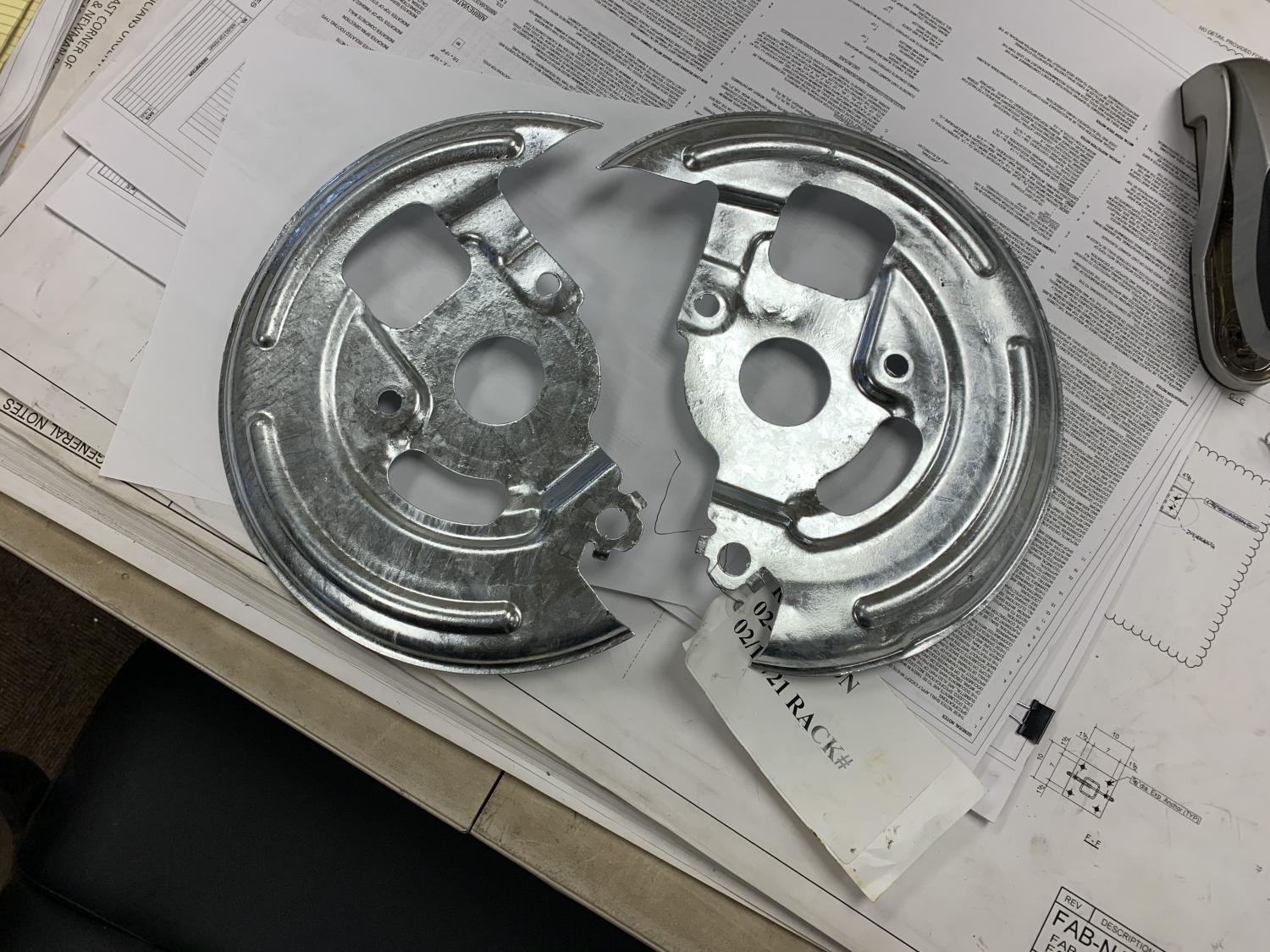

I don't have my hands on these yet to take close up pictures but my guy sent these to me today of the finished product.

I use the same process on Galavnized parts as Rick (SS427) does... multiple Zinc rich paints including bright Galvanizing Zinc, cold Galvanizing zinc, and weldthrough ZINC and use a piece of ccrumpled up AL foil to give the crystalizing effect..
