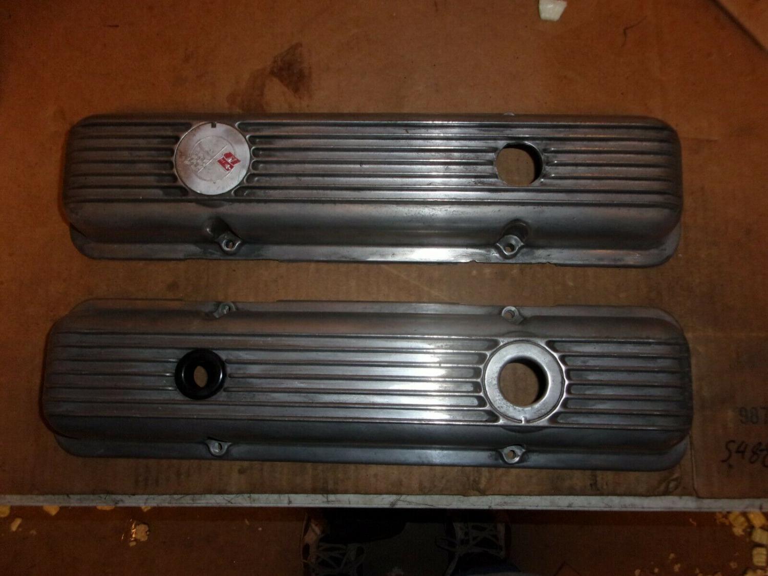

The son of the previous owner who had the restoration done took possession of the car toward the end, and along with changing the ignition, had assorted ARP bolts installed as well as chrome hold down and thermostat housing. What belongs in the manifold vacuum port with the blue anodized plug?

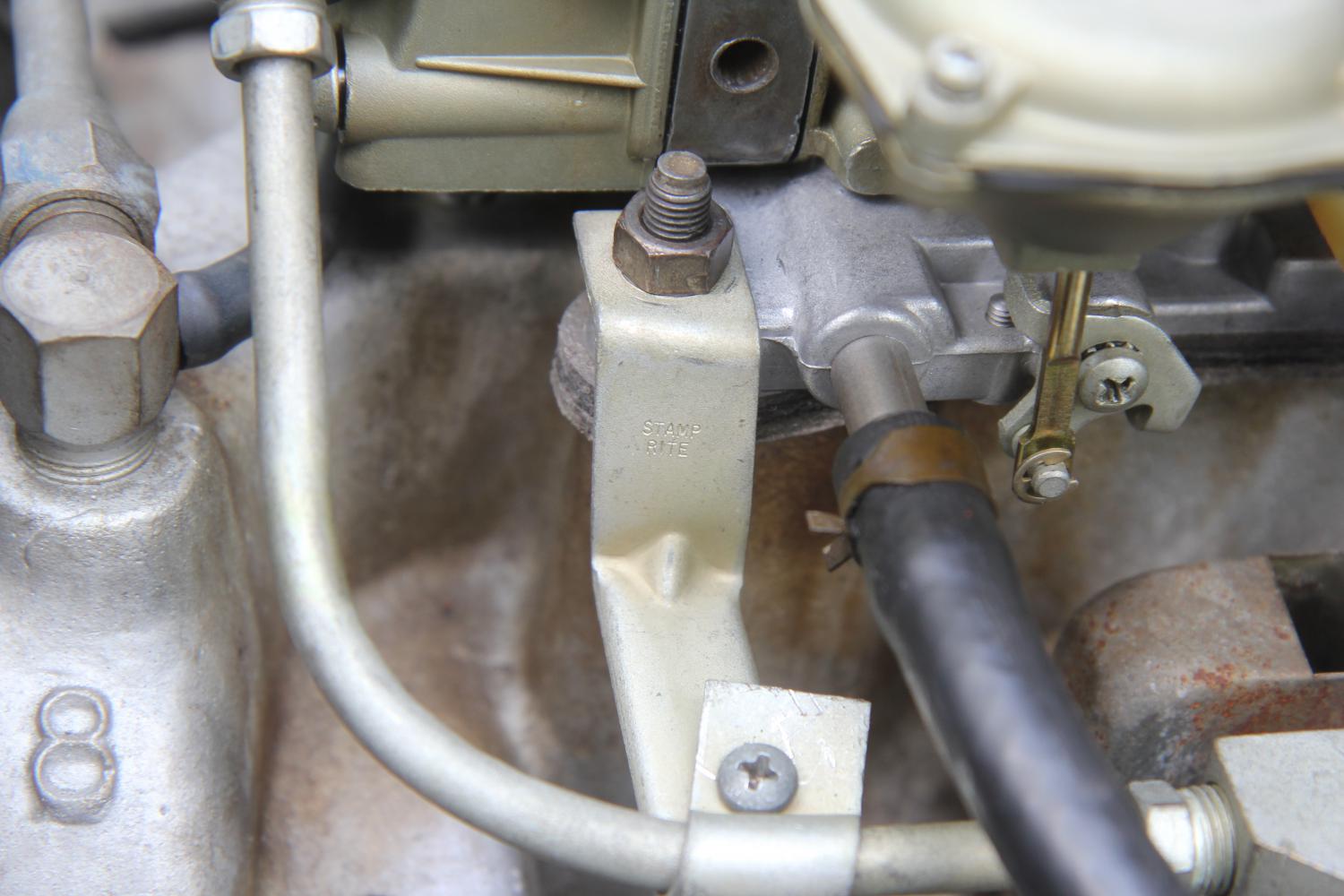

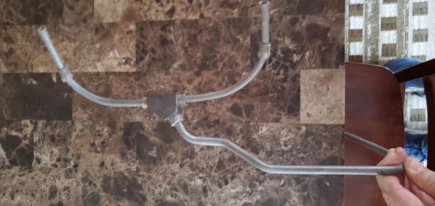

Rear intake hole should have a fitting for the Power brakes and then another port for the vacuum take off.
Here are photos of the fitting and the pipe which bolts to the throttle cable bracket.
The first photo was taken the day the car arrived and The STAMP RITE bracket should have had an indented hex head screw not a pan head phillips. (it is correct now)
