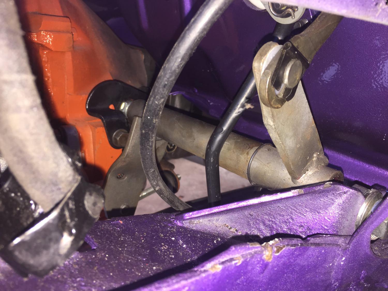

I tried to install the shifter/column interlock hardware yesterday but I figured out that I have to remove the clutch cross bar to do it as the bellhousing mounted bracket for the interlock cross bar actually has a hole that the clutch crossbar ball-stud goes through. Ugh! That will take a bit more time this weekend. I also had to make my own .610 wide, thin, plastic bushing for the large hole in the column lever that engages with the rod to the interlock cross bar. Anyone have an actual part number for that particular weird bushing? Since the cotter pin hole is so close to the rod's shoulder, the bushing has to be rather thin for it to slip over the end of the rod but still allow for a thin washer and then the cotter pin to access the hole. You cant just use a grommet on th elever - the rod end won't protrude far enough out to insert a cotter pin or clip.

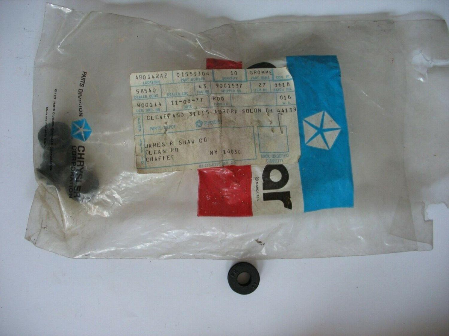

The four speed interlock was only used on 1970 models. They got rid of it for 71. So it may be hard to find a parts breakdown. I looked in my old parts book under item 36, section 19-46-13 grommet and came up wih 1553304 grommet and 1553305 bushing? As indicated, there is not really any listings other than "column shifted manual 3 speed" indicated.
Here's some interweb photos to show what it looks like. The problem is that the length of the section of the rod that goes through the bushing is not long enough to go through that bushing and grommet and still allow for a clip to go through the hole. Very strange. I might just stick with my hand-hewn plastic bushing for the moment just to get it mocked up.
Once I get the contraption in tomorrow I will be able to actually see what end of that rod goes into the column lever. It really seems that it bends one particular way in order to reach the bell crank (with the small tipped end on top) but who knows, I could be wrong...stay tuned.

After finally getting the bellhousing mounted bracket installed (after completely removing the clutch cross shaft) and then reinstalling the clutch cross shaft and then the shifter/column interlock cross shaft, I could see that I had identified the wrong end of the linkage arm as the one that engages the column lever.
One of the problems you run into when referencing factory "catch-all" diagrams is that they don't show all the possible permutations of the parts. Nowhere in the books do they show a diagram with both the clutch cross shaft bracketry and column lock out bracketry combined into one picture. And the linkage arms they show aren't necessarily in the right position in real life as in the diagram - the "flipped" arm being a prime example. If I tried to install it in the orientation shown in the diagram, (with the small end up), it runs right into the clutch cross shaft and never reaches its corresponding mounting arm.
So, once I got the lever flipped over, I could see the longer "nub" would actually clear a regular grommet and sleeve on the lever. So I got that all installed using some old GM grommet and it works great. You place the shifter in reverse and turn the key off and remove it, and the column locks the shifter in the reverse location. Until the key is turned to the run position, the shifter will not be operable.
So now I guess I can hunt down the Mopar factory 1553304 grommet and 1553305 sleeve in order to be "matching part number correct."

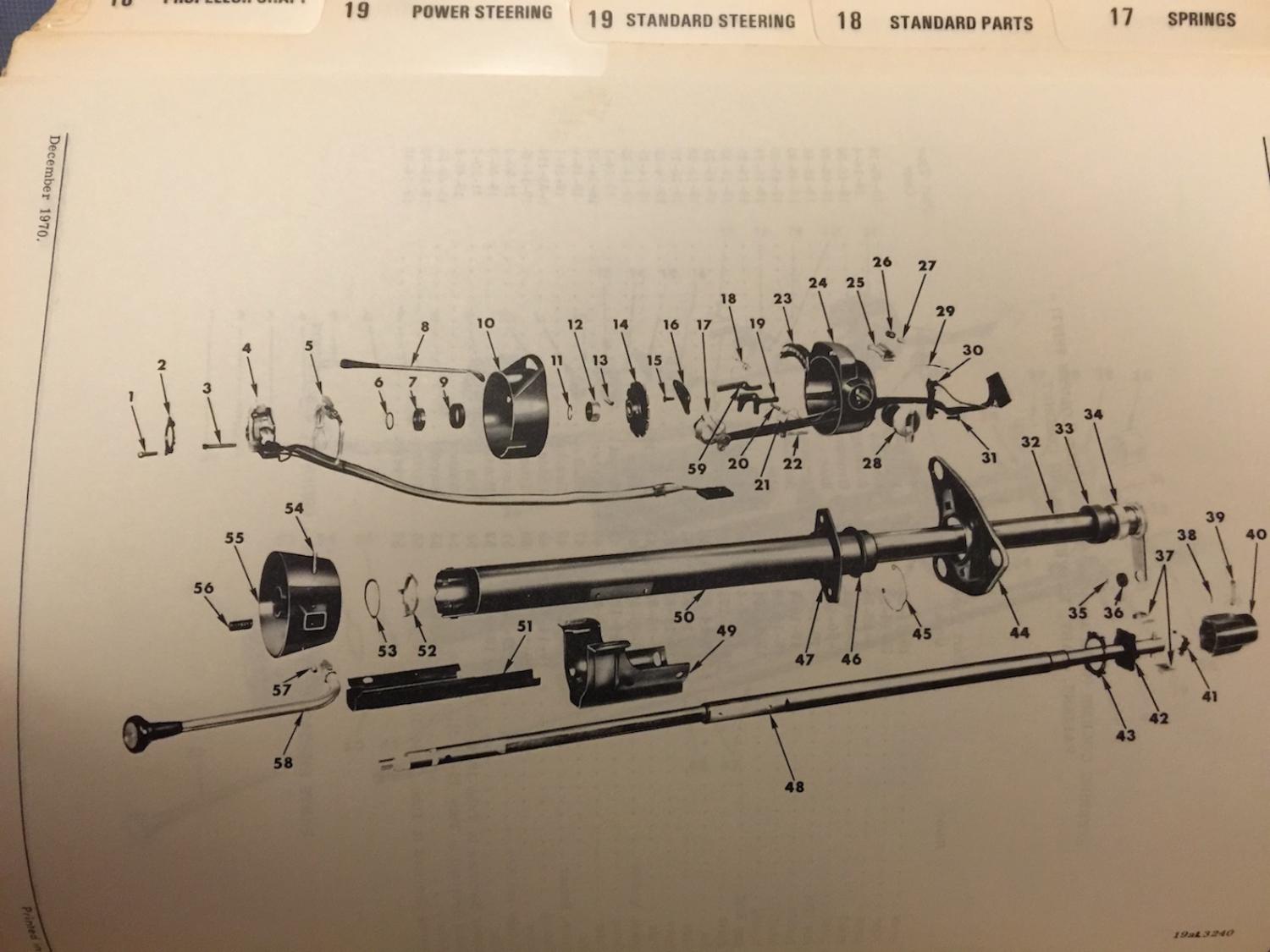

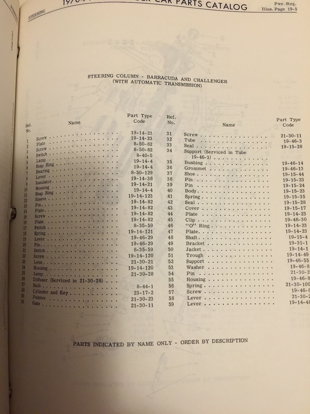

So I looked at your Post #865 on p. 87, which includes your pic of the lock assembly items -and- the illustration from the Chassis Service Manual.
I’m, also, re-posting my Parts Catalog photo illustration pages with the addition of circling the areas in question/discussion & related. Even though it states “MANUAL 3 SPEED TRANSMISSION,” I believe that there is a lack of a 4-speed illustration because the parts are, for all intents & purposes, the same (or, at last, close enough that they wanted to conserve paper, not unlike cleaning out spray guns inside cars). I rechecked my earlier printing catalog, and, although it is, by-&-large, from December of 1970, in actuality, I have pages (including Standard (non-power) Steering) from as early as May 1970, so it provides a wealth of info (including parts (and, illustrations thereof) which made it to the catalog, but were cancelled in production, and, therefore, deleted from subsequent printings of the catalog).
ROD 19-48-1 (upper left-hand corner of top illustration) is “ROD, Gearshift Lock Col., w/3, 4 Speed Man. Trans. Floor Shift, 70 B, J (Barracuda, Challenger)” in the Parts Catalog (pn 2996 413)
CLIP 19-48-23 (same illustration) (used on both ends of the 2996 413 Rod) seems to be “CLIP, Gearshift Lock Trans. Rod w/4 Speed man. Trans. Floor Shift” (pn 1635 232). Quantity shows “1,” however, it is, also, listed as “AR” (As Required) in the same section. Worth some research. By description, this is the closest, among the possibilities, however, I ain’t guaranteein’ it’s correct.
“WASHER” (The 2 shown at the top attachment point do not show any PTC (Part Type Code), i.e. 19-48-23 above. That USUALLY indicates that it is just considered Standard Parts (Section 18 in the Parts Catalog); items where you just have to replace what was there with something comparable, or similar, (or, in their absence, ascertain what you need). …And, why does one of those “washers” suspiciously resemble a grommet? Hmmm…)
Steve stated: “I looked in my old parts book under item 36, section 19-46-13 grommet and came up with 1553304 grommet and 1553305 bushing? As indicated, there is not really any listings other than "column shifted manual 3 speed" indicated.”
As per our subsequent phone conversation today, playing “Devil’s Advocate,” I asked him why he thought that the pn 1553 304 grommet, and, the 19-46-14 pn 1553 305 bushing were applicable (#s 35 (invisible) & 36 in the steering column illustration), even though the grommet is showing for “Strg. Column Gearshift Tube Lever” -or- with “Auto Trans. Floor Shift,” and, the bushing is showing for “Auto. Trans. Column Shift.” His reply: “Because it is there!” (Kidding!) In actuality, looking at the parts illustrated (both in the catalog, and, in Steve’s detailed photos), despite lack of info, and/or, conflicting info, in the Parts Catalogs & Service Manual, (and, of course, the bonus being that Steve has the parts in hand), those part numbers appear to be highly probable choices.
The moral of the story is that, though I greatly appreciate them for what they offer, Parts Catalogs are incomplete (as are Service Manuals); Illustrations (especially pre-production ones) can vary from ACTUAL production items (i.e. Steve said that there is no swivel/adjuster in the upper half of that 19-48-1 lock rod), and, “exploded view” perspectives can, at times, lead one to not fully understand the relation of one part to another in “as assembled” form. Add to that, that Service Parts can vary from Assembly Line items, designs change, vendors change, and, on, and, on, until, sometimes, it’s just a conundrum! I/we thought that this might prove helpful. I learn something(s) new every day. If this has helped someone, great! …And, if anyone can shed additional light on the subject(s) that would be much appreciated, too!
