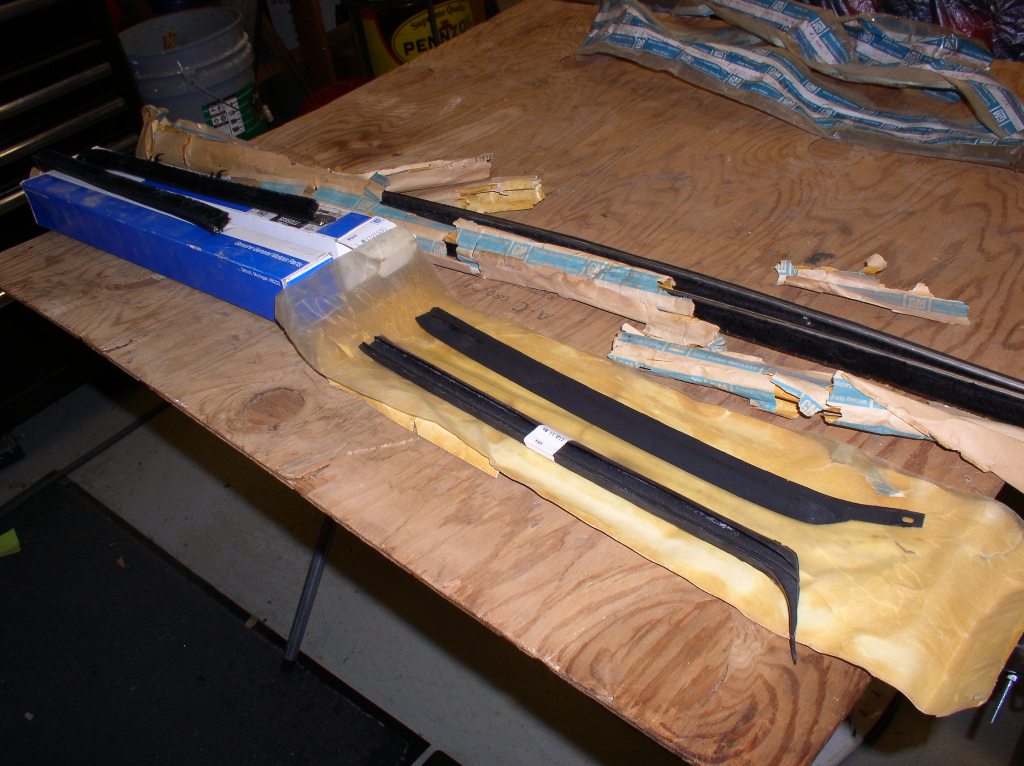

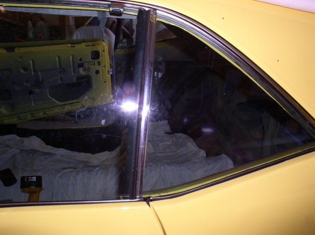

I spent some of yesterday doing the first glass adjustments. It's real close. The final adjustment will follow after headliner, windlace, & roof rail metal is in place for the last time. I had a couple of brackets wrong inside the doors so that took a little time. Today I laid out some of the NOS parts that I would use today. Installed vertical seal & outer window seals (fuzzies). Also installed the "U" shaped rubber pieces in the door jams.

Finally got one the items for the car, the melt pad for the trunk. One of our members here was nice enough the send me one he had laying around. Warmed it & the NOS trunk mat up out in the sun for a while & then installed them. Trunk mat was also purchased from one of our members. What a great group of people. One more piece of the puzzle....Joe
