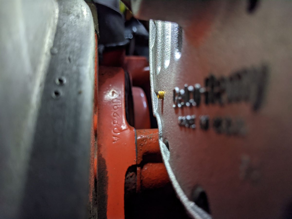

Would like to hear from KurtS on the engine stamp. Hard to tell with all the paint, but I don't like it. Like William said, doubt it would have had the partial stamped down by the oil filter.

I dont think theres any way of confirming that engine pad stamp the way it is with all that paint covering it.
It looks like V0829DZ

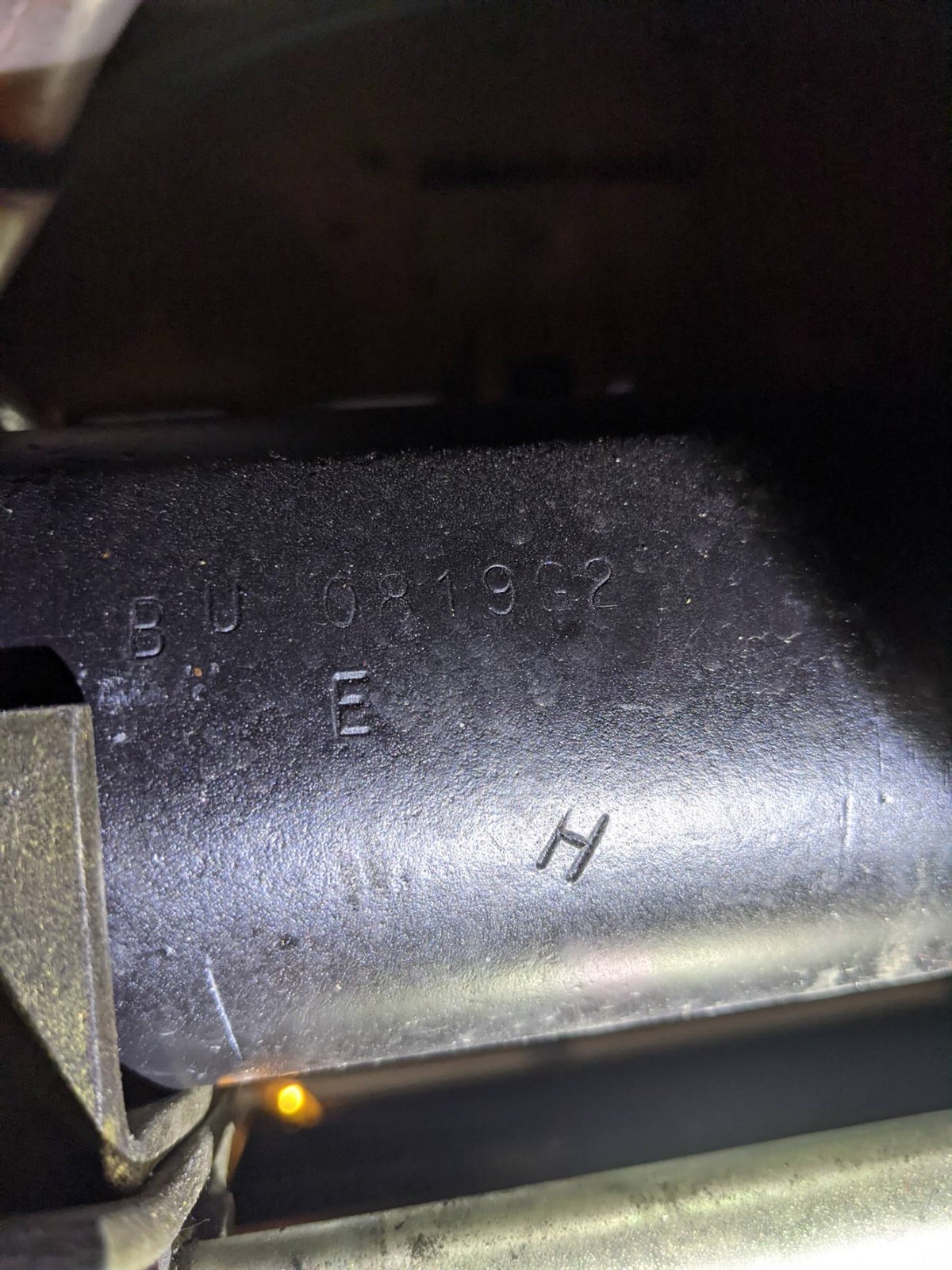

The rear axle tube stamping. The B looks like it used to be a P??

I'd have to see a better pic of the pad without paint to make a call.
WS is real. Axle probably is OK, could just be the lighting or a bad hit (PU is a 10 bolt in 69).
