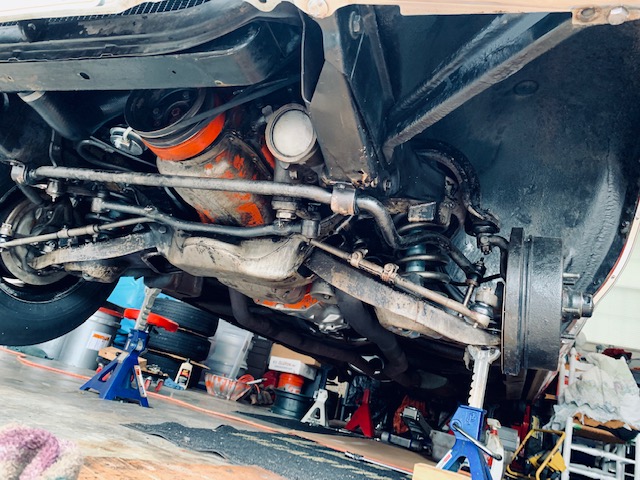

Here's a teaser. Cleaned, degreased and evapo'd. No repainting or refinishing of any kind. I'll share products and processes once the car is finished.
We look forward Darrell!

That looks so good Darrell...
