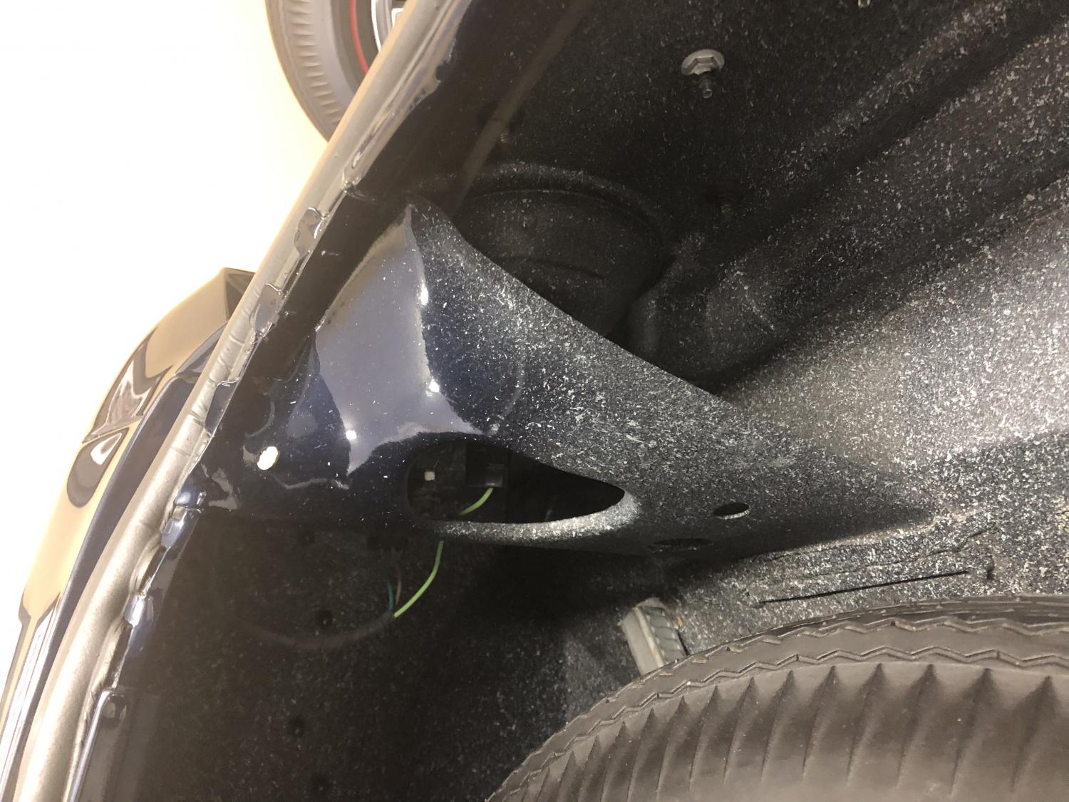

Here ya go Dave. As a side note, I used the original unrestored trunk finish in my 05C Norwood car to duplicate efforts in my 03A Norwood project. In doing so, the "Black" appears to be a very dark gray, so I mixed the SPI epoxy base to match...then worked on the setup and my technique to approximate the spatter size and density.

My Z has the dark epoxy base coat and then the gun was set up to spit an aqua spatter. Turned out great
Picture makes it look metallic! Looks better in person
