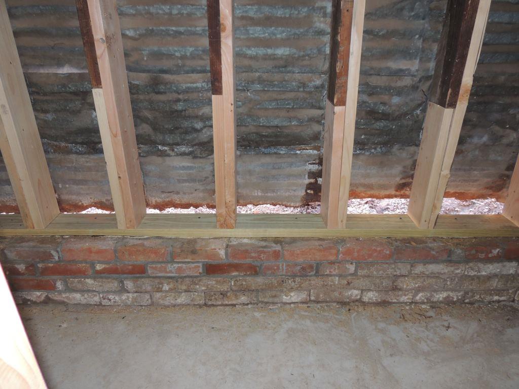

Anyway, I got the wall rebuilt. There was no way to install proper anchors in that brick wall, as we only tore off the top 3 or 4 courses, down to where it was solid. So, when I put the pressure treated sill plate on, I just screwed tapcons through the sill plate and into the brick, at least one screw between each set of studs, and sometimes two. I was a little nervous when the City inspector came out to inspect my framing. He liked my 3/4 inch anchors in the NEW stem wall, and then asked about anchors in the old. I told him the building was built in 1922, there was no requirement for anchors at the time, and because I wasn't doing new construction, I did not have to comply with modern building code. Fortunately, he agreed. he gave me a few things to do on the "honor" system before I covered up around the doof frame with OSB. Good thing, as it was the 21st. Surgery was scheduled for the 23rd. I still had to go pick up the door at the truck terminal.

Got the door picked up on the 21st. Left right after the inspector left. One of the projects the inspector gave me was to nail metal strapping from the sill plate all the way up over the door header. Had to run to the home center on Tuesday the 21st, and luckily they had what I was looking for.
Jan. 22. Started nailing the metal strapping. Fortunately, I got help from my brother and my good friend Greg, along with his wife Sherryl. Greg has a fork lift. No way I am getting that door up there without a fork lift. It weighs over 500 pounds. Greg planned on showing up at 2 with the fork lift. It was crunch time (and both of my shoulders were doing a lot of "crunching" by now... after all, there is no cartelage in either one).
My brother came over in the morning, and he and I started putting up the OSB on the inside frame around the door opening. Meanwhile Sherri is uncrating the door. I should have downloaded instructions so I could read them before hand. Oh well.
Just as we were getting the supports mounted to the header, Greg shows up with the fork lift. He is a magician. Got it right up there on the first try, centered perfectly. From there it is just a matter of bolting everything in place. Greg had the fork lift back on the trailer and was headed home in about an hour.
I still haven't put the weather stripping on, and still haven't removed that little bit of dilapidated wall on the West end of the door way. From the outside, you can't even tell I have a roll up door yet. Still have to take the old one off, and remove that wall. But, I am not going to do that until we have some good weather. Boy, was I ready for a few days off when I had my surgery... the next day.
