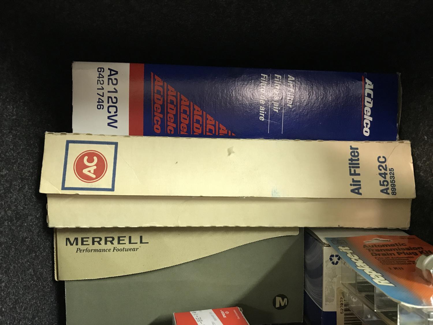

I was wondering same, I just found one in my parts. Not sure why I even bought it.its not for my car lol

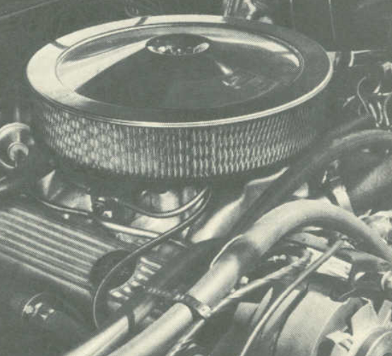

The expanded metal mesh was used during the 1969 model year.
Z/28 feature, Road Test magazine August, 1969.

Tim Expanded metal 212 is correct for your LT1, just make sure it has the full saying with "Best Way".
