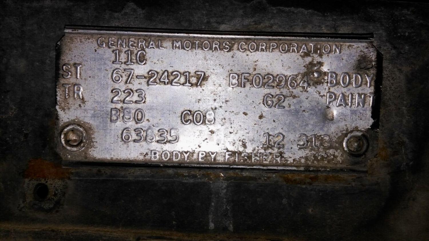

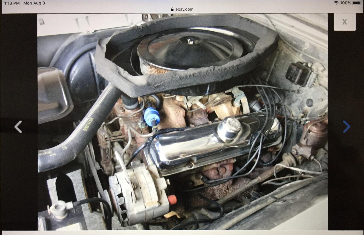

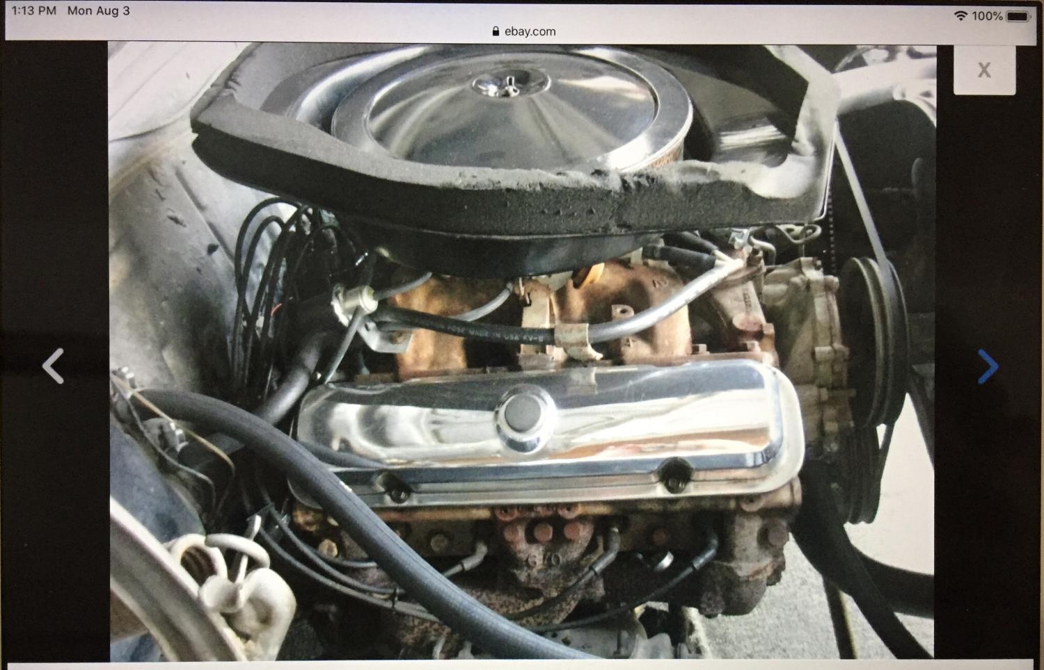

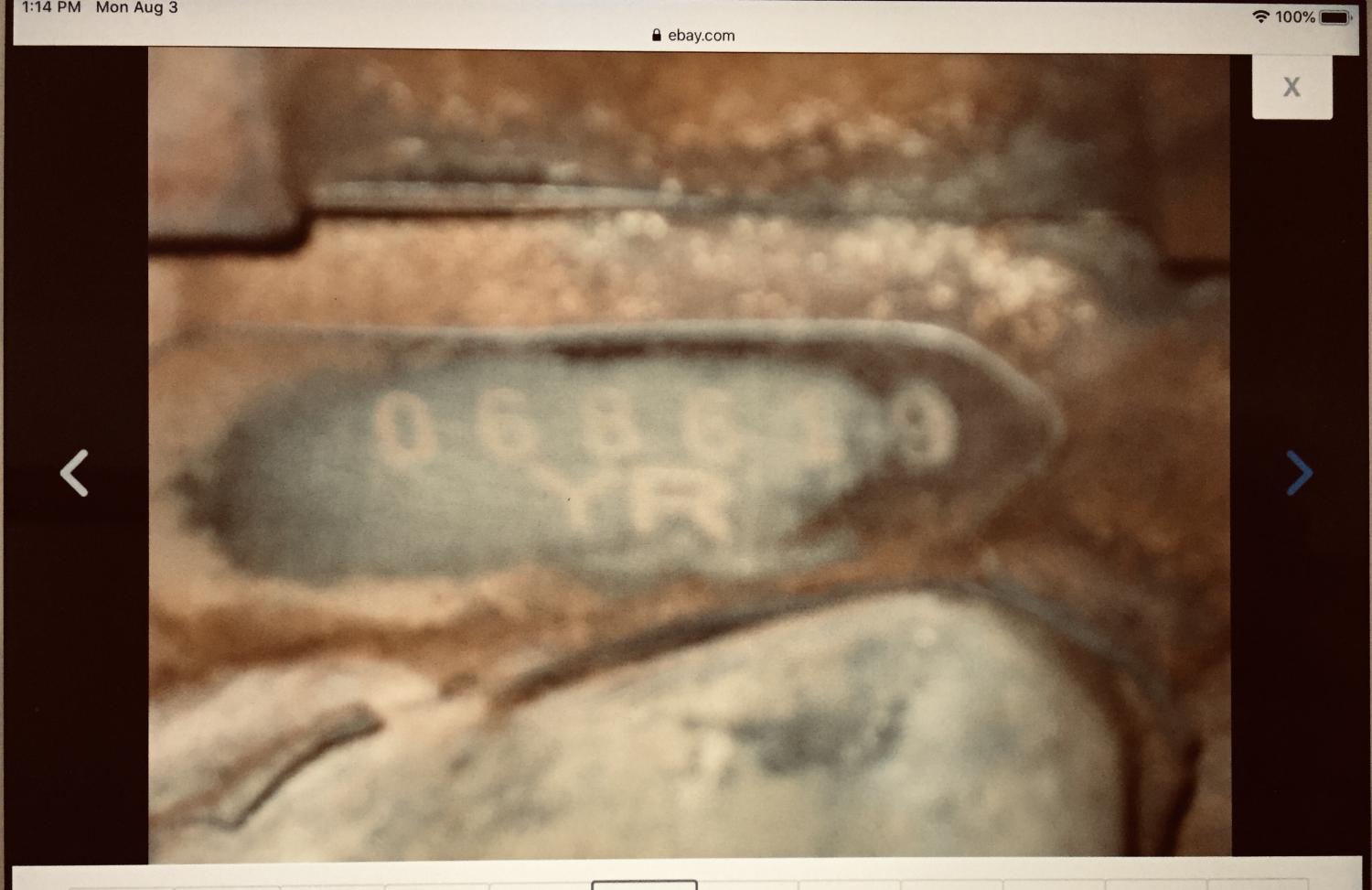

Seems like a pretty solid deal here - original RA car, one repaint in the wrong color (was Signet Gold), and looks to have the original engine assuming that EUN stamp is the real deal (the pic is pretty blurry). The character lines in the quarters look like they've had some filler work, but the car looks pretty solid underneath.
Whole lot of car for the $42k buy-it-now price and I'm assuming the reserve is a few grand less than that.
Link to 1967 Ram Air GTO auction
242177Z108086

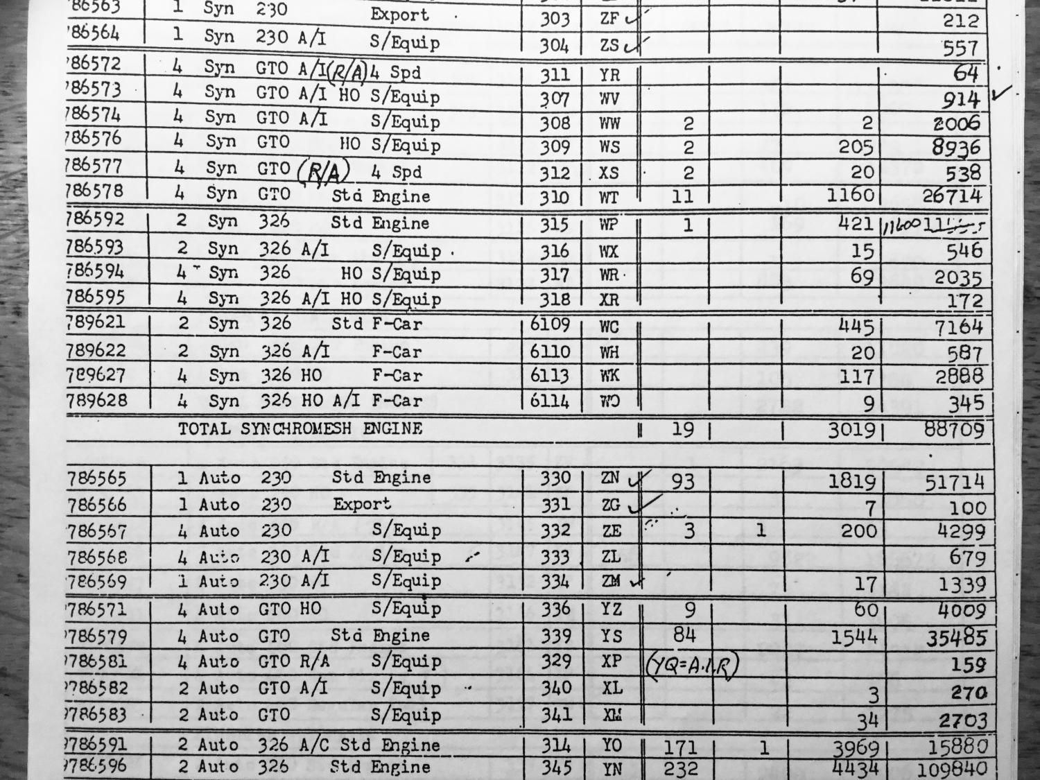

Actually only 64 of this configuration were built.
1967 YR = R/A 4 Spd. A.I.R. Third line down on build chart.
The most important “born with” component is still there, the numbers matching engine.
