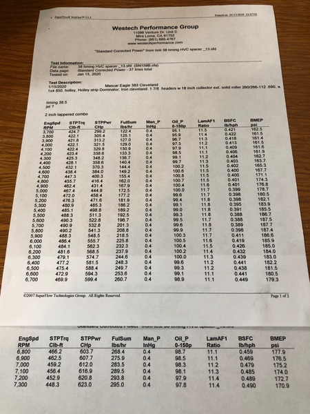

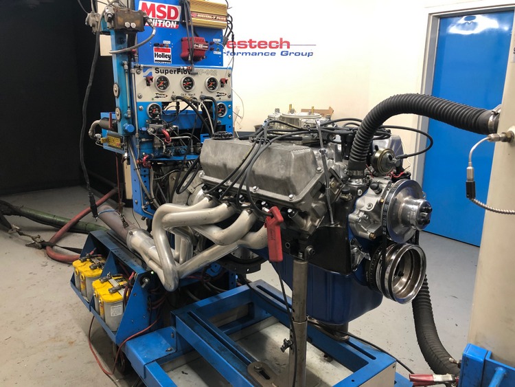

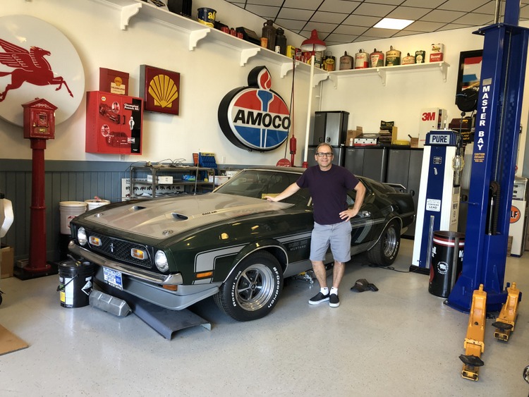

They are Killer I have owned a few. This Green one was my first car when I was 15 years old. My friend Ron still has it. I just rebuilt the original engine for him last year. With some cheater work these things are screamers.

WOW KEN! Those are impressive numbers, what compression did you build it to? Original 11:1 or higher? Is he running the Strip Dominator and headers on the street??

12to1 Factory D1ZX-CA with .500 removed from divider, yes headers, everything else looks stock. It made 590HP with the stock intake manifold.

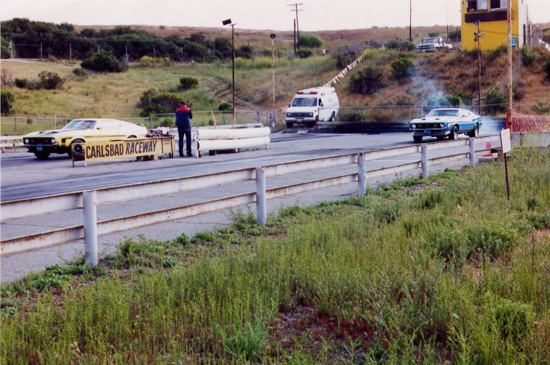

My Buddy Dan is the Original owner Of a Yellow Boss 351. When I fist met him, it was 100% stock, At the time I had a Grabber Blue Boss 351 mine had headers, 750 Holley and a mild cam, I even lowered the compression down to 9.6 to1.. I talked him into going to the Drags. He ran 13.90S Again All Stock.. I was running 12.70s with a Very mild Low compresion Boss motor.
