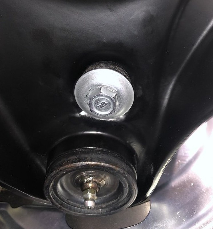

The front sway bar is now painted and back in the frame with restored original hardware and some NOS bushings & end link hardware with correct bolts. Looks way better than it did before. Here are a few before and after shots of the front suspension to add a little perspective of the cleanup work. (lol)

(Installed a set of NOS end links and bushings on the sway bar. Bolts have WB head marking).
(End links installed showing the underside of the a-arm. I need clean this up a bit when it's off of the jack stands and more accessible).

Graeme, great work on cleaning up the front end components. I noticed that you replaced the end link hardware with NOS parts and this may not matter, however the end link bolt with the WB (Wales-Beech) head marking used on 69's was a Grade 3 bolt with fine threads. For some larger GM vehicle applications the bolt used was instead a Grade 5, with 3 radial head markings as shown on your replacements, which is also course threaded. The correct bolt has no radial markings.

Always fun to learn a lot of things about these cars from you and others Lloyd, and thanks for the info on the bolts. The ones sourced will stay in place and although they do have the radial markings, I'm just fine with these in there. I'm trying to clean it up some while addressing some obvious concerns during the process. In doing so, I am sure there will be a few errors but I do appreciate being corrected as there is always more to learn with these cars.
