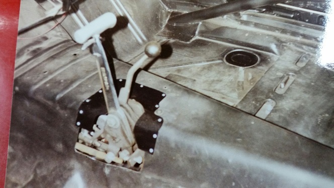

I posted another reply on Team Camaro. I didn't cut much of my floor. Picture is when I had the Ramrod in it, but the hole size is the same.

Yes, the Super Shifter mounts the whole shifter body higher and to the left, so the hole has to be cut out larger for the body and rods to fit. It doesn't matter what handle you put on it because the shifter body is what requires the larger hole. If I get a chance later today I'll post pictures of the mounting bracket for the competition plus and the super shifter so that you can see how much the shifter body is moved.

Here is one of my Super Shifters mounted on my new AutoGear N24. You can see that the shifter is mounted much higher and a little to the left.
