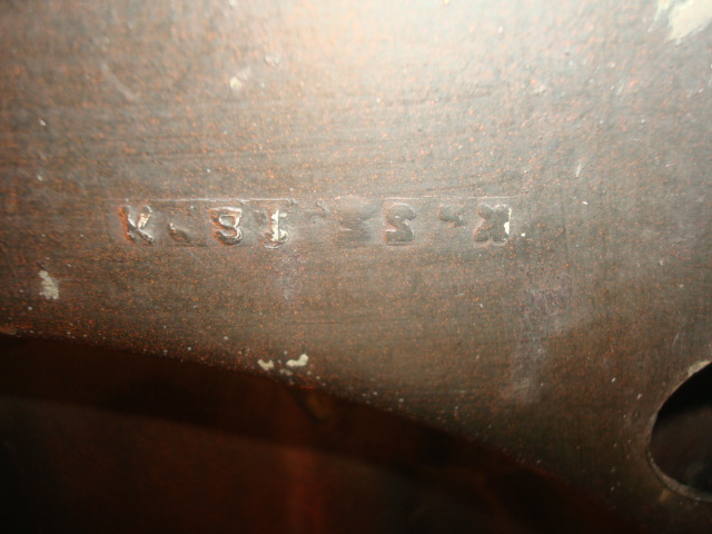

Spent some time cleaning the undercoating off the floor boards of the 69 L78 conv today.

Its amazing how the under coating protected them. I used a heat gun with a plastic scrapper and them wiped them down with solvent from my solvent tank.

Thats good to know. I found heatimg the first layer with a propane torch goes much quicker, then use a heat gun comes right off.
Looks like the floor brace is K22 and the car is 11D seems like body parts were made right before the body was assembled.
Thats it I am done scrapping leave the rest for the next owner. The driver front floor has a little rust not bad for it being a PA car most its life
