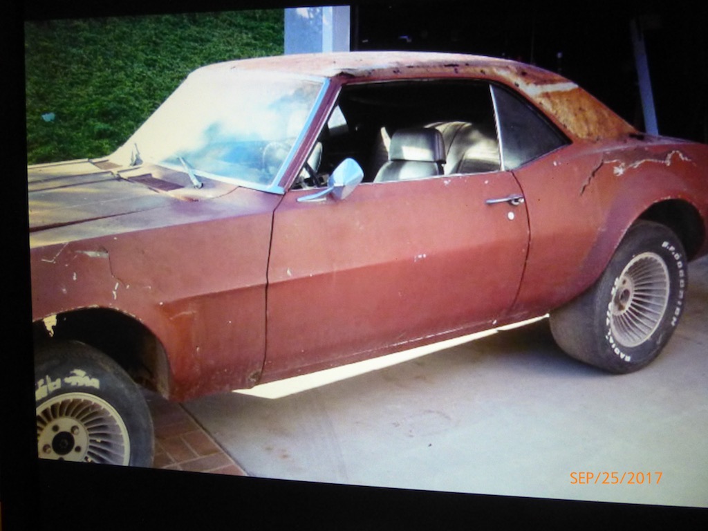

Could it be possible that the JL8 option was ever ordered/installed on a standard 1969 Camaro that is factory equipped with a 307ci engine and a Saginaw 4 speed transmission? Thanks in advance!

Yes, it could be ordered with any 1969 Camaro regardless of options.

Calling Gregg Lusher, you can help out here.

Yes, Gregg found that very set up. I saw it when he brought it home after pulling it out of a California field.

The option was more expensive by a significant amount if it was not a Z28 or SS I believe... ~$625.00 sticks in my head? ~

Mine was ordered with 307, 4 speed, factory air, blue light stereo, vinyl top and of course the JL8 option. It had June of 1969 dated Delco air shocks and trailer wiring still present when I found it. It was delivered new to a dealer about 30 miles from the Van Nuys plant but was built in Norwood due to the JL8 option.

Gregg, how about some current photos?

Whose car is this? 307 V8 with AC:
Good memory! Per CRG Options list:
$623.50 for non-SS, non-Z/28
$500.30 for SS and Z/28
Does that mean no JL8-optioned cars were assembled at LOS, or just in the timeframe yours was built?
