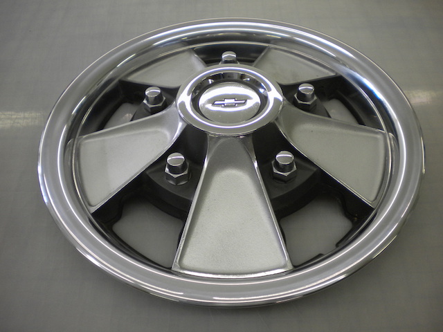

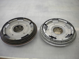

Default Mag cap comparison
The cap on top is the '67-'68 version, bottom is '65-'66. Primarily the '66 cap has smaller vent holes and the center cap appears separate from the spokes while the '67 cap has larger holes and the center cap appears molded into the spokes.
I believe the painted spokes came in '69 or '70??
Willow green is a great color, really pops in BC/CC!!
Bill W

Bill, Thanks for your wealth of knowledge. I purchased the larger hole with the cap molded into the spokes. They're Black spokes so they must be 69-70. Either way they'll look good. This site is the best car forum going. Thanks Yenko.net.
