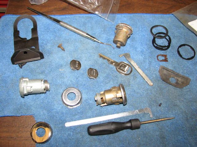

Being a master locksmith by trade, I still have NOS Briggs & Stratton locks here that I've been holding onto for decades. These are the same locks that were made for GM and I have them in correct GM keyways for 69 cars with original keys and coded heads. All the cores are original gm keyways and I can key them correctly. With a few complete sets left, I can key and Ignition w/ Trunk, and both factory original door locks to NOS glove box cores I have here as well.
They are all packed away at the moment but I'll dig some out in a few days here and get some pics off to you if you'd like a set. Happy to help as you've done some solids for me with parts needed.

What is this key slot or slotted tab you guys are referring to above? Here's a typical kit using original cores from Briggs & Stratton

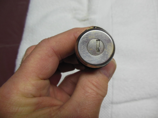

here is a original trunk lock the doors are the same in looks

Posts: 12,350
Bingo!

I’ve rebuilt mine and salvaged the OEM notched flapper and used it with a new cover. PITA to take apart, but the results are perfect.
I agree, pet peeve, straight slots look like ...well they’re just wrong.
