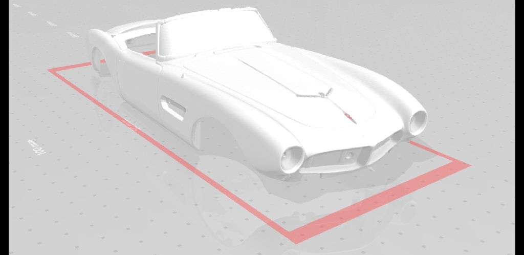

The scan is done and it's moving forward to dividing the model into stations now. Woohoo!

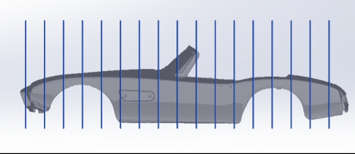

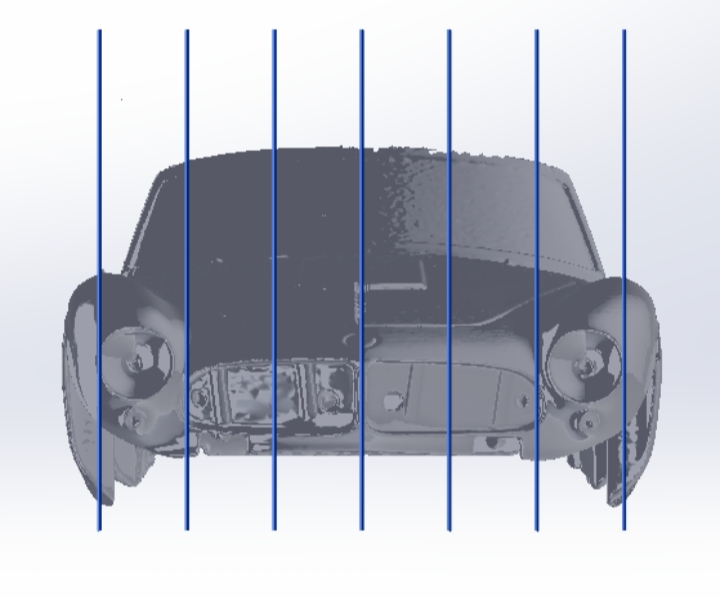

More to come...they’re almost done with the CAD design. The latest email showed me the placement of the body buck stations as well as the stringers that will run longitudinally down the body. Think old-school style Gullows balsa wood model plane.

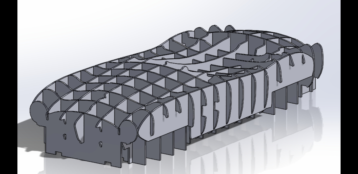

... and this is what I mean! I got this email yesterday and it's identical to what I envisioned. I think we're pretty close to being done with the CAD work and then it's onto getting it sent over to the CNC company to router out the design in 3/4" plywood.

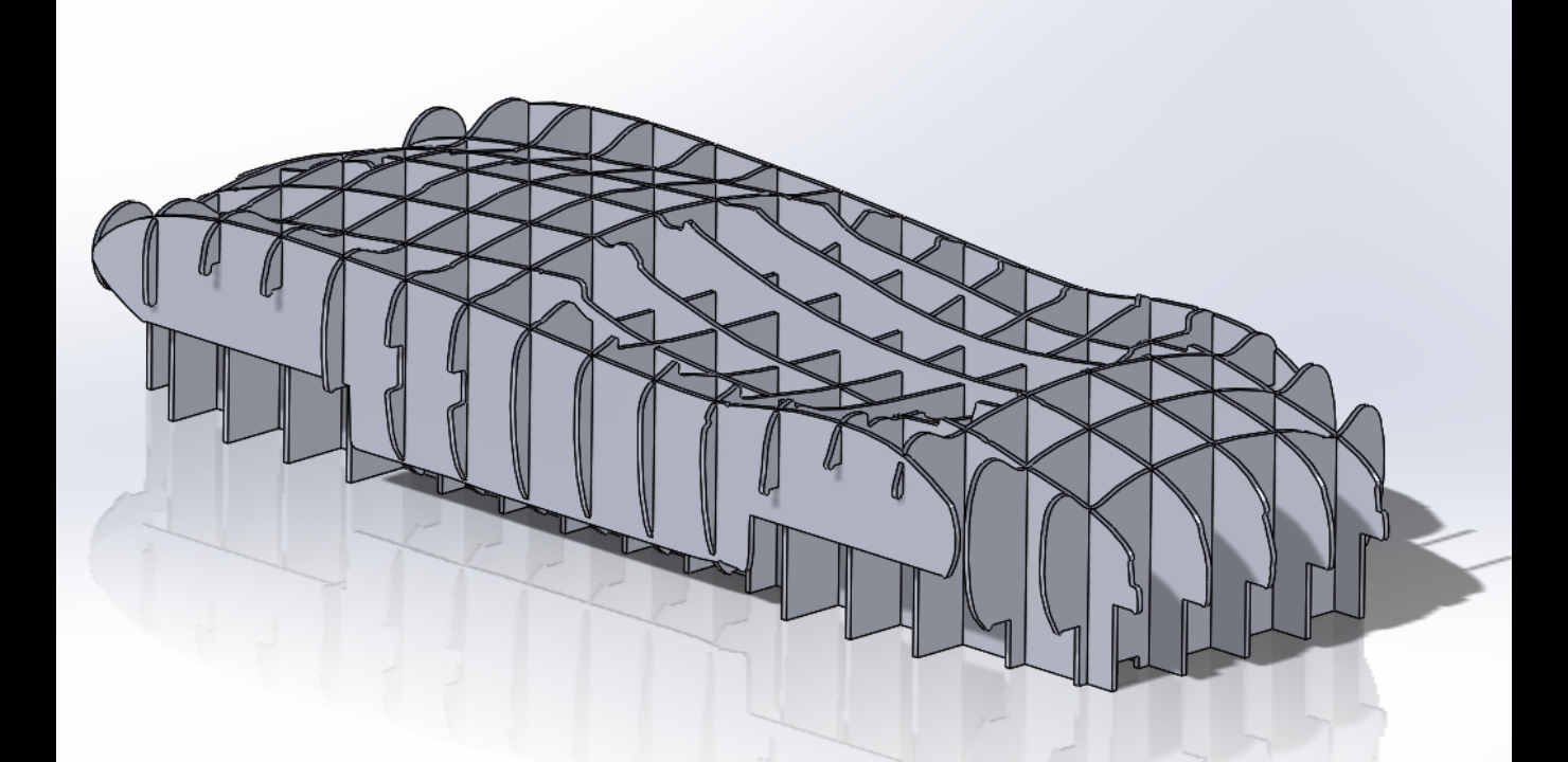

More progress progressing forward! Latest feedback from the CAD people is this rendering which shows the skeletal sections under the sheetmetal body to verify fitment. What you see it's what I'll be getting out of wood, both horizontal and longitudinal. All parts will interlock and they'll be a keel down the center foot rigidity as well as alignment proposes.
This is a snapshot of a video they sent me, but I'm technologically challenged with trying to upload this tip YouTube. But fear not! Videography at it's finest will be forthcoming!
